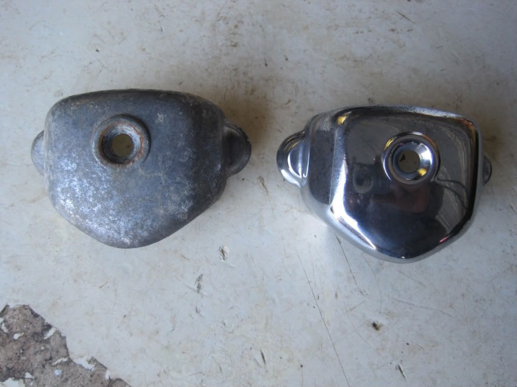

Not bad for my first time.
The buffed cover has some pitting but over all it's very shiny.

Did you find the adaption of the bench grinder to do buffing work satisfactory?  From the picture it appears you bought a fairly large buffing wheel, is it 8" or larger?  Also, did you have to buy any sort of spindle adaptor to put the buffing wheel on the grinder?  I ask because I've been sort of looking for a good cheap used grinder to do exactly what you have done, convert it to a buffer.  My plan is to set up to buff, hit all the parts at once, shoot them with clear coat and call it a day.  So, is there anything special a person should know before they set up or is there anything you would have done differently?

Did you sand it down first? Using a sanding pad on a die grinder will get that pitting out. It's nice and shiny but a little more effort will really spruce it up, IMO.

The bench grinder worked fine. There were a few instances where I had to pull away from the wheel because the motor was slowing down. It is an 8" buffing wheel with a 1/2 whole. I just eyeballed it and used a few washers to lock it in place. After a few spins I trued it up and spinned perfect. I would like to find a 1/2 adaptor or I may rig something up myself.
I did not sand first. I wanted to see what the wheel would do as is. I was pleasently suprised. This was really a trial run for things to come. Any recommendations on sanding pads for my die grinder? I assume there is a grit rating on those as well.

If you want to get rid of the pits then you need to sand it smooth first.  Whatever scratches or pits you see before you start polishing will be in the final product.  I do not believe the exact sanding pad matters, also it may be a good idea to use a sponge pad under the sanding disk.  Sometimes I dont use a sand paper at all, and instead use a 3M roloc wheel (7443).  It leaves a nice finish, and will remove small pits.  The results are not as good as methodical sanding, but with the right high speed drill you can prep some pretty rough pieces for polishing with that roloc wheel.
Its more important that you dont leave scratches from the sanding disks, you need to go up incrementally in grit, you need to make sure you take out any scratches left from the last paper.  Although if I am using a power tool then I usually just start with a 220 or 320 grit (which doesnt lave deep scratches anyway), then move up to 600, 1000, etc.  If you are using a power tool then I wouldnt go below 220 unless you have some serious casting marks or pits.  With a power tool the 220 will take out most anything.
On a side note, I polished my rear hub the other day and I was unable to get a perfect finish, it still has what looks like water spots.  The surface is perfectly flat, and with out scratches, the discoloration appears to be in the metal.  So take my advice with some hesitation, seeing as I dont get it right myself.  This piece was sanded thoroughly with 220 grit on a DA first, and it still has this odd discoloration.

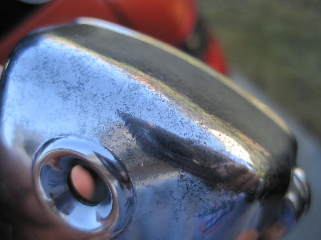

Do you think polishing shops spend all that time wet sanding to level out a surface? Answer is no. The thing to use is what's called greaseless buffing compound available at caswell or eastwood. Your hands and arms will thank you later.

This is my pic from the initital post in the thread. I got it from the cover on the left to the cover on the right with only using gray buffing compound and a buffing wheel. I want to remove the pitting. Would wet sanding with say WD40 remove it or would I need to use a die grinder?

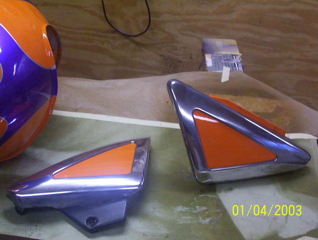

I need to remember to consult this forum more often...I just tried my hand at this today...bought buffing wheels 'A' and 'B' at Home Depot..with a little rouge kit...stuff looked better than when I started...but reading this post shows me what I missed.
Great info guys ,thanks for sharing!
I buffed the side panel trims up before I re-installed the newly painted plastic parts.

What are those off of?
My buddies Yamaha maxim 750 that I painted...not Honda relevant...but somewhat on topic ::)
