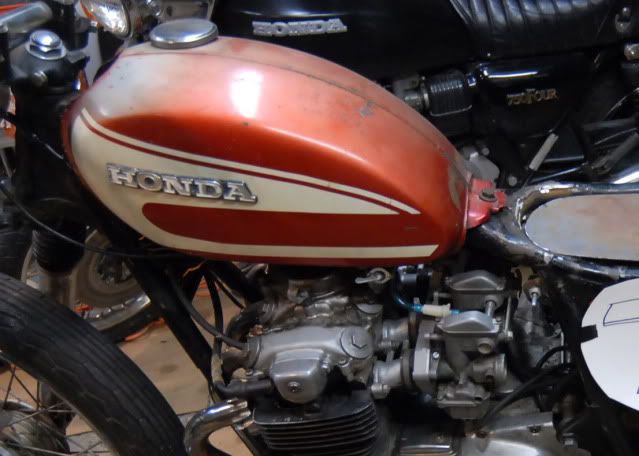

I used a 76 750F tank on my 550 build.  Not a simple drop-on though.  It required the steering stops, and front pins both be modified, and a new rear mount fabricated.  Because of the length the stock seat will not fit any more as well.  The 400 SS/F tank would give a similar look, with a lot less work.

My plan, with the tanks I've been trying out, has been to place the tank where it clears the steering and then when its where I want it to just relocate the standard Honda mounts to accommodate my desired mounting spot.  I expect to have to cut off the pins that currently emerge from the frame as well as cut the rear mount off.  Then I will replace the pins (with bolts of the necessary length welded to the frame in the appropriate places) and relocate the rear mounting tab as necessary.  I just love Honda's mounting system, that's why all of the tanks I've been looking at are Honda.  The most recent one I've bought (there are damned few around here to look at in person) is from a late 70's CB200, with the pad running down the middle - very square and boxy looking, something that should compliment the engine shape nicely to my mind's eye.   We'll see.
Right now I've got a dummy seat-pan mockup made and part of it (its nose) will eventually be cut off to become the foundation for the rear tank mount; just cut it off where ever the length of the new tank dictates, weld it down, weld the stock mount to it and I'm done.
The reason I mention what I intend to do is just to note that once you get it in your head that you're going to have to make new mounts anyway, and realize how easy that is going to be to do, it really opens up the world of tanks you can be taking into consideration.  As for the petcock, I really don't care where its located as long as its on a side and not the middle.  Tubing is cheap and the flow rate is so slow that you will never starve the carbs for gas because you added a few inches to the length to reach the other side of the bike.

One thing to watch for with petcock position is interference with the carbs.  I forgot about that, and got lucky when it ended up between the #1 carb and the engine. ::)  Do agree though that it doesn't matter which side.

i was going though the same dilemma a while back. i tried 350 twins, 360 twins, cl350, and 750 tanks. i settled on a CL125 tank. the petcock clears the carbs (and is on the left side). it was really easy to mount. i cut off the front posts, drilled new holes, got some round stock. it actually stayed in place without being welded. i cut down the 2 "donuts" to about half size. for the rear mount i just tacked a nut into the frame and bolted the tank down.
