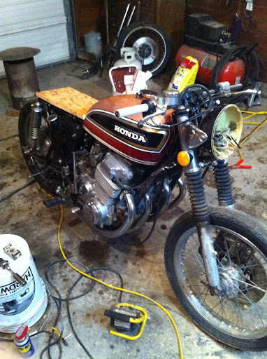

Wiring back in, installed some flat bars, tank all cleaned up (C.L.R bath on the inside) carbs cleaned and rebuilt, fuel petcock leak fixed

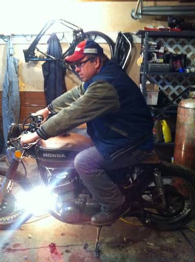

Test fit... Fat Guy on a little bike...

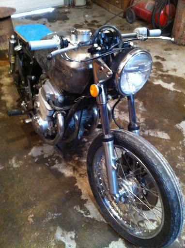

Tank stripped and artfully modified -
Rear end clipped, Pipes clipped, initial seat design installed  - no the pipes were not mint condition priceless heirlooms--- they were all 4 rusted through, crumbly, swiss cheese.  I picked this bike on purpose
And here we are up to date - front caliper rebuilt, master cylinder cleaned and working, forks cleaned and new fork seals installed, new clutch cable installed, nice crisp clutch actuator from one of the other motors installed, headlight back in
