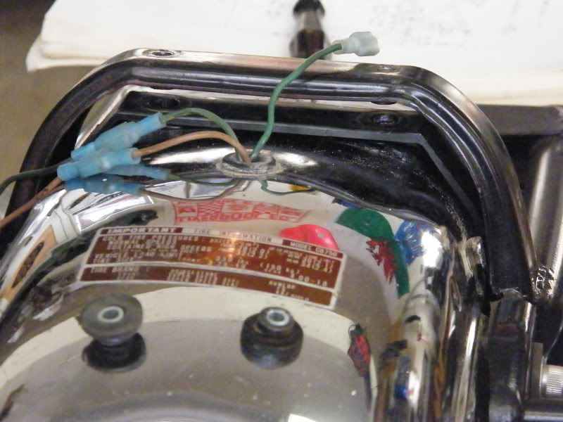

Okay its been 18 months since I stripped her down and although I put the parts in small boxes and marked them I seem to have a few minor problems :) which Im sure the knowledgeable members here will sort for me :)
I know the wires from the rear light / turn signals need to pass under this area but Im not sure what the spacers were? I do however have these two left from the appropriate box but I dont see how they would fit .
Please see picture :) any help would be most welcome :)

What bike & year is that? I have a K8 and will go look now. I'm not sure what spacers you are talking about?

1971 CB750 K1  the two spacers are sitting on the back of the fender but I dont think they are the ones.

Those look like the vibration isolation grommets that go between the tail light and bracket with the two little bolts. the wires pass under that black bracket on the left side.

I'm sure the 71 is alotttt different than mine did you check your taillight to see if those grommets go there?

Also a few of those are also on the battery box. 76CB750F
