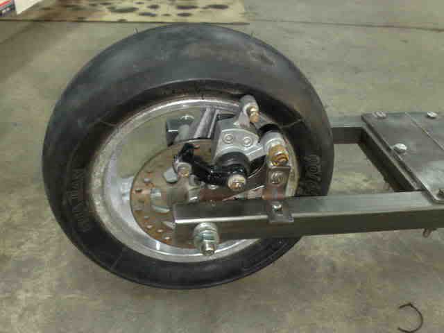

We have fitted and adjusted the rear brake caliper today...
