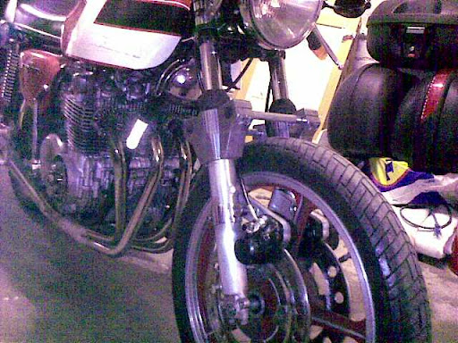

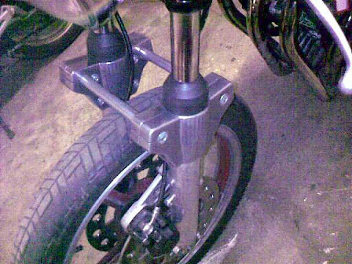

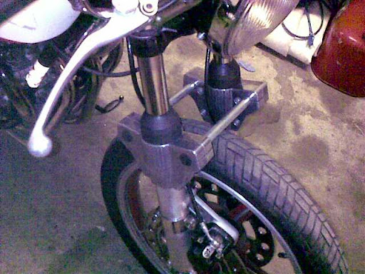

This is what I call a fork brace:
Offline Goofaroo
  • general nuisance
  • Posts: 468
Re: Structural integrity of Stock forks w/ out fender?
« Reply #112 on: January 18, 2011, 01:08:30 PM »
Now there's an example of a component being designed strictly for utility with absolutely no consideration given to aesthetics.
Up-sprung weight and it detriment to suspension response comes to mind...but I'll bet it is stiff.
Aluminum parts are hollow and those pipes are not so thick walled. I like when form follows function and I was very happy finding this period accessory.
I was going to say its probably lighter than it looks.

They definitely have a frim grasp on the top of those fork legs. Any idea of their origin?
I found it on ebay.de - cannot recall if it had any markings.
