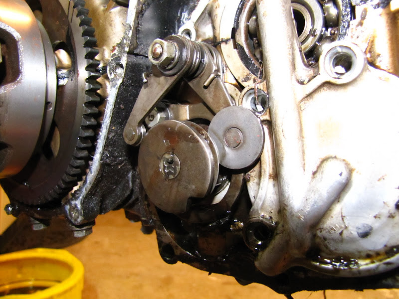

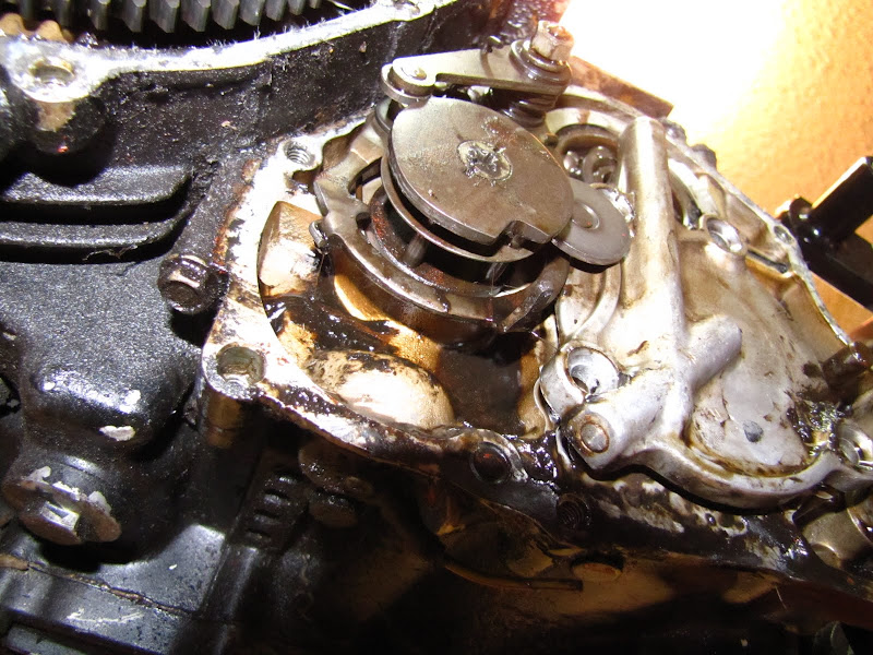

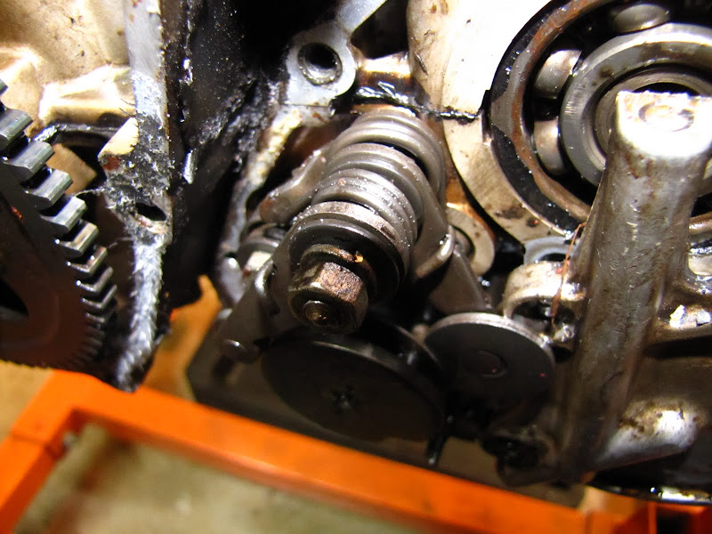

Okay, I feel like an idiot. I got this bike in a box. The engine was completely disassembled. I'm having an issue getting numbers 10, 8, 9 ,7, 27, 17, 16, 12, 27, 34, and 33 together. Anyone have a clear photo of a real bike?
Thanks guys!

yep I do...let me see if I can find it
Logged
MATT
current bikes: 1976 CB750F, 1981 GS1100E
KRONUS0100
MAD MATT THE MANIAC
Expert
Posts: 1,216
Re: 1978 CB750K Shifter question
Reply #2 on:
February 02, 2011, 08:23:17 AM »
here they are

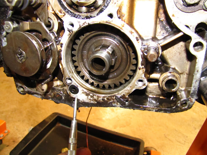

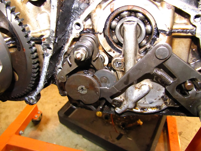

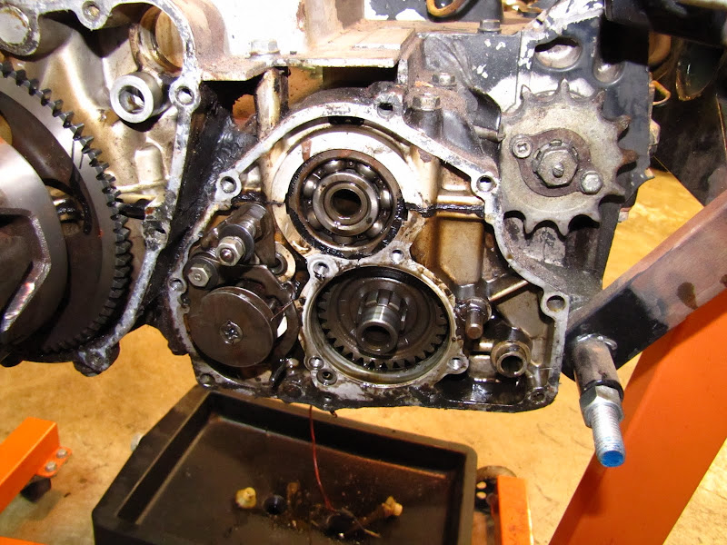

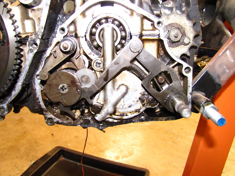

ya, this is definately a bugger to put back together!! check out Hondaman's book if you can, REALLY nice!
here's all the pictures i took of mine, please forgive the cleanliness. you can right click and go to "view image" for a slightly larger picture:
hope these help!
