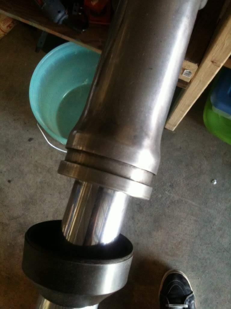

March 03, 2011, 03:36:36 PM »
How similar is this groove? (78k shown)

March 04, 2011, 04:09:41 AM »
The groove looks correct to fit the gator. Now as long as the width of the fork leg is the same as the early ones you should be good to go. Visually it looks correct. Did you pick up some gators?

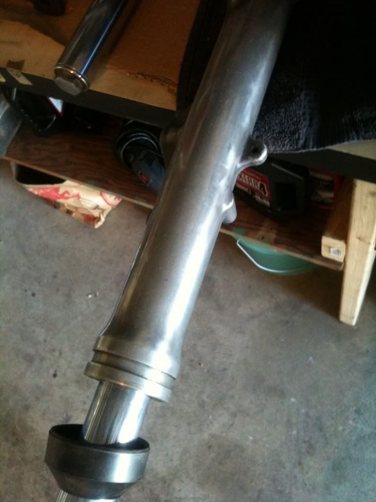

March 06, 2011, 08:51:38 AM »
This is a K6 and prior style
Bottom of gator:
Top of gator:
