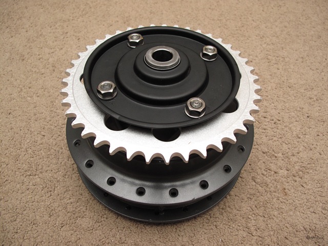

« Reply #127 on: September 03, 2013, 10:48:49 PM »
Rear Hub all test fitted together. Turned out good I think. All set to be installed after some loctite.

« Reply #128 on: September 04, 2013, 04:50:29 AM »
You forgot the spokes :P

« Reply #129 on: September 04, 2013, 07:27:03 AM »
Spokes are overrated. I'm going to go with paper mache  ;)

« Reply #130 on: September 04, 2013, 10:42:57 AM »
I think it would be easier to assemble spoke the hub with sprocket off and then install sprocket and carrier after the wheel is built up.

« Reply #131 on: September 04, 2013, 10:48:36 AM »
Oh, I know. It will be coming off before I lace and true. I wanted to dry fit everything after stuff got powdered and ensure fit was correct before I got to far into the wheel.
