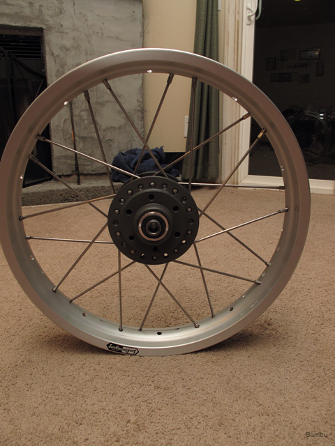

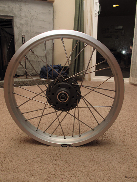

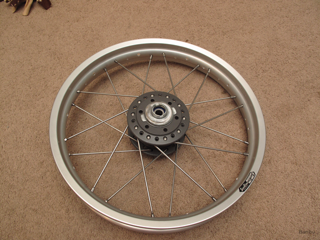

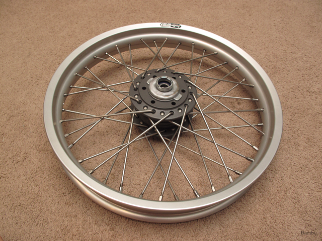

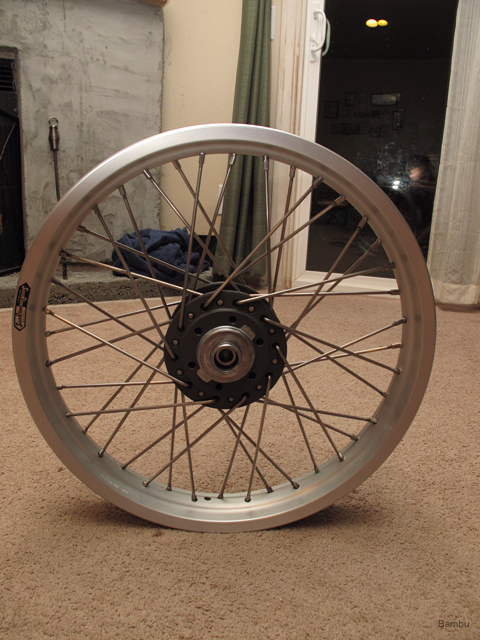

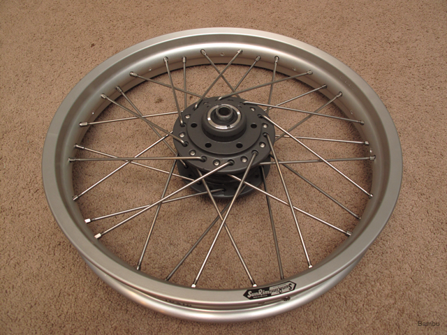

So when I got home from the business trip this week I had my new front tire and rim waiting for me! Tire is a Roadrider 100-90/18. Rim is a Sun 2.15 18".
Started lacing it up. Not the easiest thing to do in the world. Took me a few try's but after looking at an old picture I was able to get it all laced up. Next up is to true it and seal it so I can get the tire mounted.
Inner spokes on:
One side of outers added:
And all of them on hand tightened:

Couldn't resist trying the trim on the bike. It is a little too shinny so it will be going off to the chrome shop to have a new brushed finish applied.
And finally go more of the front wheel together.
