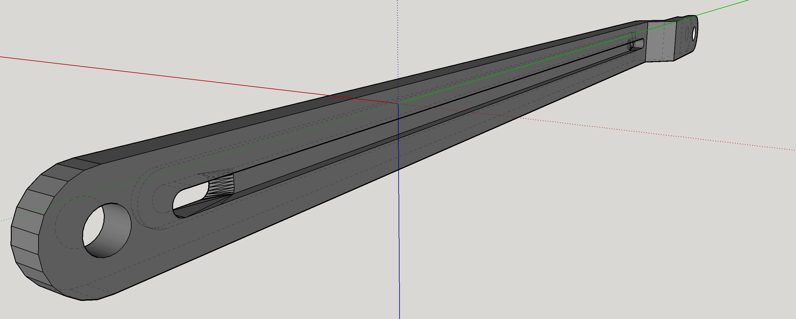

Smart set up integrating holes for the brake line!
Thanks. This is what the back looks like. I increased the hole length and added a taper.

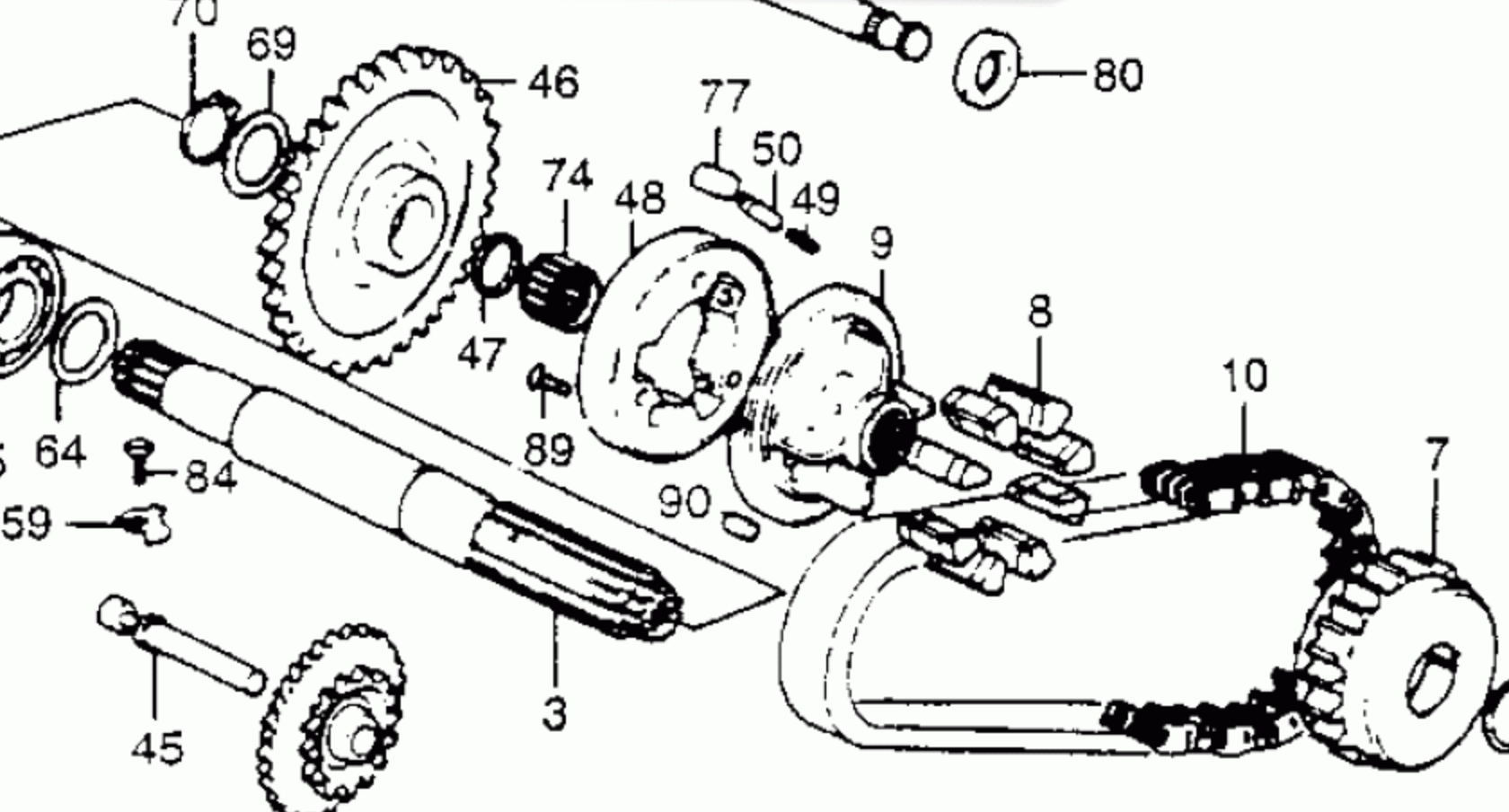

So, I'm pretty sure the culprit is the starter clutch as suggested by Scottly and Godffrey. I swapped in another starter and same result. I worked through electrical potentials and was able to eliminate all of them. Wired the new starter directly to the battery and still heard the sound. When the plugs are out, no compression, sound isn't there. What I think is happening is as the clutch engages it slips like mad. I checked it when I pulled the starter and everything felt good but since it isn't engaged under loadI'm not going to be able to tell anything.
I've started pulling the needed part numbers to order. Could use some confirmation that I've got the right ones....
I think I need 8, 49, 50, 77, 89, and 90 for the rebuild, yes?

 Those are all the right parts (might get away without #8) but having 3 of the #89 Screws on hand would be a good idea, in case they are or get booger'ed up.
 Also; you will want to inspect #48 when you have it out, it's a pressed together, 2 piece part and sometimes the inner part will crack. If so, it will need to be replaced as well.

I've seen the inner part of 48 rippled from the rollers ..

On a 750, the part that is usually at fault with starter clutch noise like yours (guess how I knew what it was right away ;)) is equivalent to #46; the surface of the hub on the gear gets worn, and the rollers (#77) skip and jump instead of wedging in, locking the clutch to the gear. Numbers 49 and 50 are non-wearing parts, #8 appears to be for a cush drive, not related to the starter, and I'm not sure what #90 is.

I have just done this and found it a quite fiddly job, and that was with the engine upside down on a bench. The new primary chain may give even less wriggle room.
