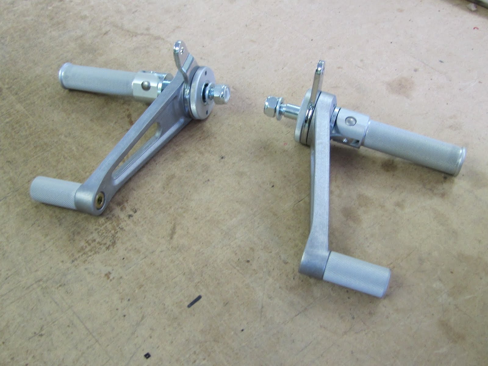

I thought of welding a short tube to the mounting of the passenger's footpegs in order to mount some universal rearsets like these here
The most probable position is marked by the red circle ;)
What do you think? Any experiences to share?
Offline Flying J
  • Posts: 3,386
Re: Cafe Racer CB 550: Building diary #welding brackets for rearsets?
« Reply #95 on: July 05, 2012, 03:11:45 PM »
I think it will bend. You could weld in a plate above that bar and bolt it through that. Its going to need more support then just one weld from the top. You need to be able to stand on the pegs and not worry about them coming off.
