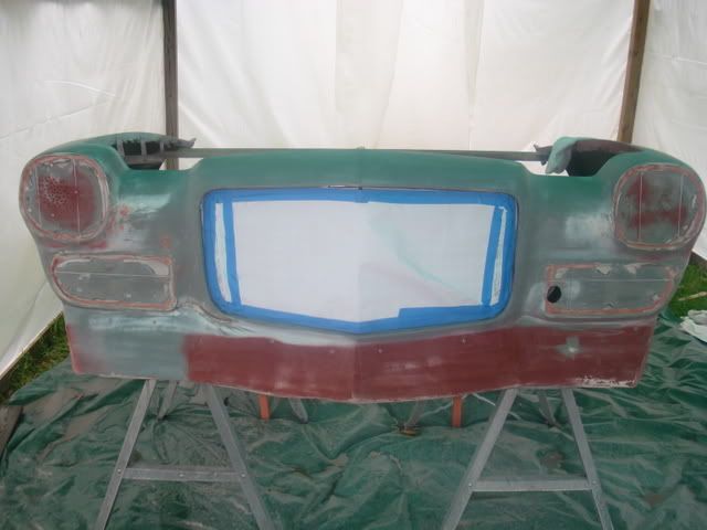

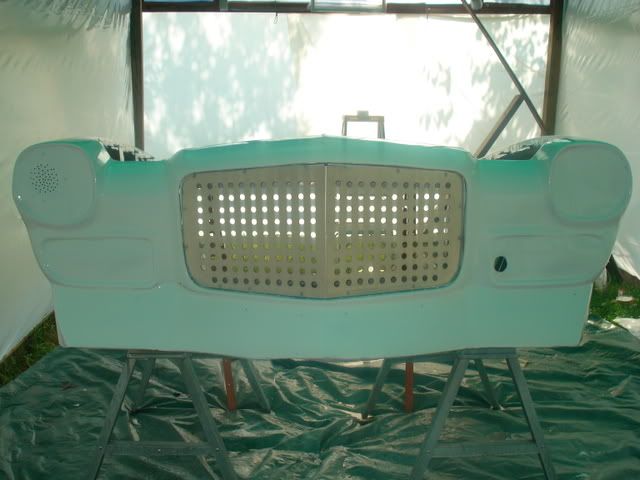

have faith.  keep the air clean, thin with Xylol, light multiple coats then a wet last coat for gloss.:
Rustoleum paint job.
