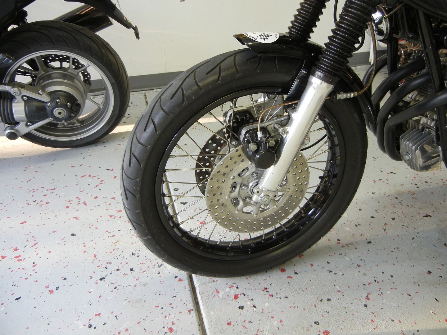

I never checked but was hoping that the duel set up with drilled and thinned rotors from member Godffery would yield about the same weight as the original single rotor. Does anyone have any info on the difference in the Godffery rotors vs. stock weight?
This whole thread reminds me of Smokey Yunick and his rule "interpretations" in the NASCAR world. Here is a guy that built a 7/8 scale car to save weight and acid dipped his body panels to make them paper thin. What a genius!
If you also flip the fork legs and calipers around to the back side, it will make the steering lighter. The downside (as known by modern riders) is that the forks gain stiction while braking heavily because of the applied angle of the forces against the legs, and the pucks get wetter in the rain. This was a popular roadrace mod in the day...
I have seen bikes like that but never new what the advantage was, thanks for that.

« Reply #209 on: November 20, 2017, 03:46:05 PM »
The triple tree spaces the fork legs forward of the stem axis. Having the relatively heavy calipers at the rear of the legs gets them closer to the turning axis of the stem. This reduces the moment of inertia of the steered mass. Probably almost noticeably.
