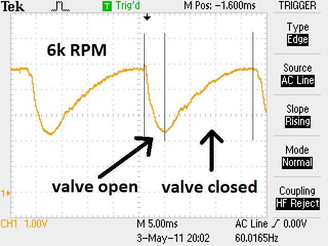

just a thought for a vacuum sensor, where are you going to hook it up? if you use the vac ports then how are you going to sync the carbs and have the bike running at the same time. your other option would to be drill and tap somewhere and how many people are going to be willing to do this? just an example the ecotec i-4 platform gm has the 2.2l originally had a wasted spark system. once it was switched to a cop system a gain of only 2 hp was reached. more drastic hp improvements came with the addition of vvt. bamboozler i like your current setup ideas. things to ask yourself would be what does the market want. and how cost prohibitive would a four coil system be. adding four coils would add price and what about mounting are you going to supply this or leave the end user to fab something up? a system that is expandable would be an exelent product.

If the ignition system does not sense vacuum because you have removed the vacuum sensor to do a carb sync, then it will assume that the vacuum sensor is defective and automatically revert to the wasted spark system driving both coils at once. The system would have to do this in any event for a "limp home" mode in the event that the vacuum sensor fails.

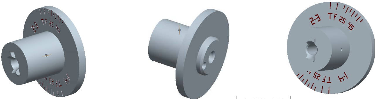

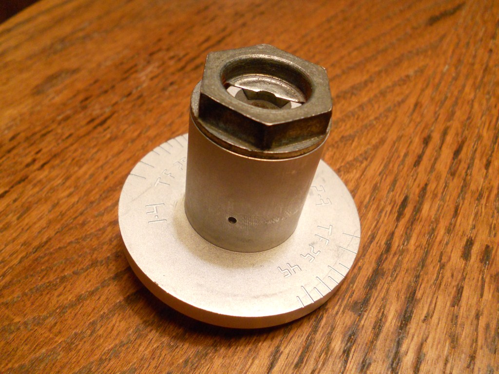

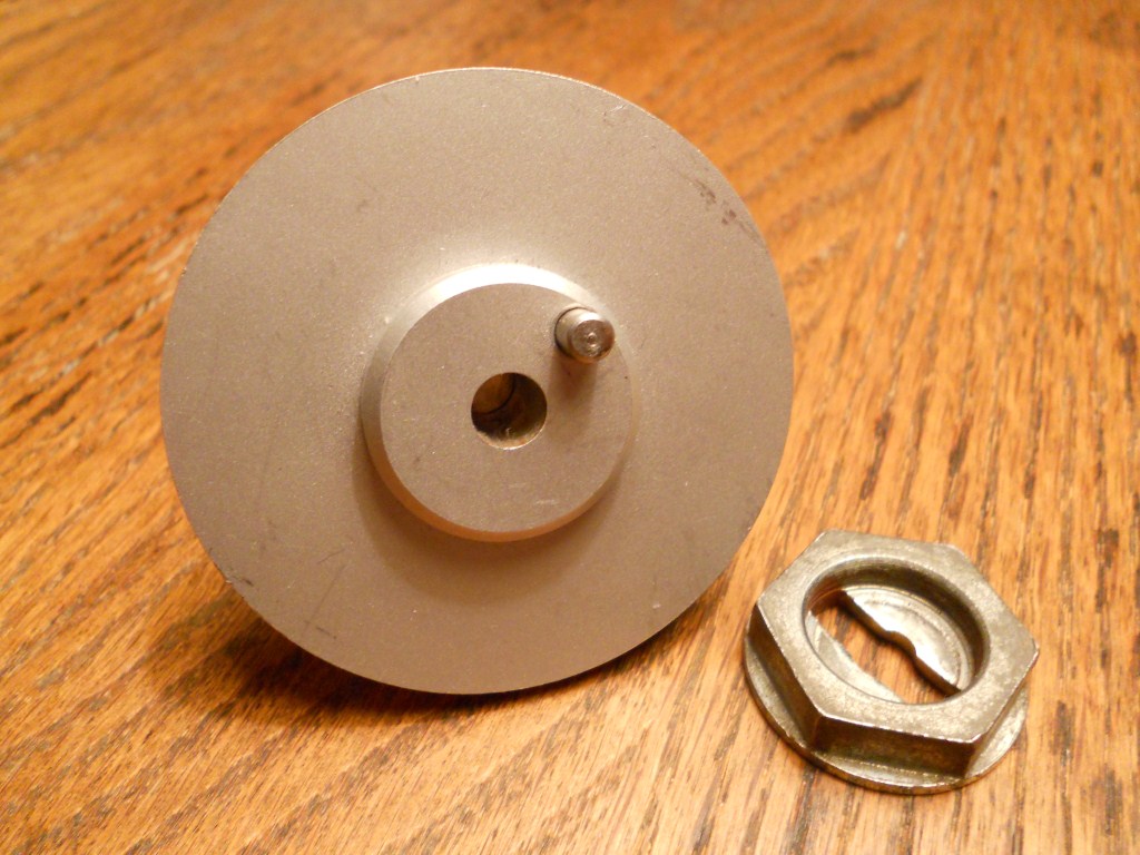

To hit up a bit more regarding this ignition here are a few pics of the rotor.
This is the first 7075 aluminum prototype, it fit reasonably well for a first turn part.  For the most part it's a dupe of the existing stock advancer, you can see the similarities.  The stock washer and fastening nut are able to be retained to rotate the motor.  Slight adjustments where made with the index pin and magnet location based off the prototype.
