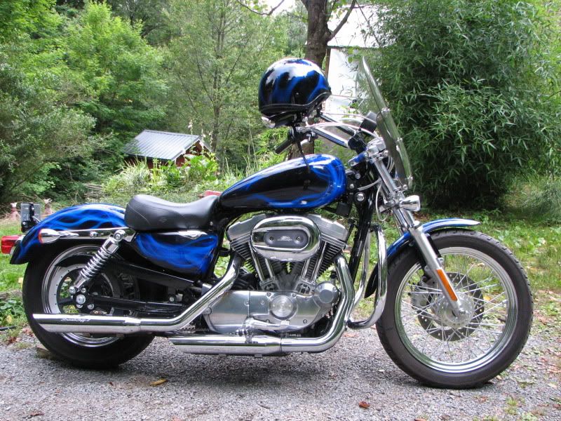

I bought my wife a 2005 883L two years ago (used bike with 297 miles on it).  She had the same problem, being even shorter than even the "Low"version of the Sportster allowed for.
Not a problem now though.  First off I believe the 883L shocks are an inch shorter than the standard Sporty shocks (they didn't make the L model in 2000 but they might very well fit).  Then I bought a really nice set of lowering blocks (chromed billet) for it that took it down another inch.  Finally she got a solo seat for it that was more accommodating of her as well as being a bit lower than even the stock solo seat that came on the bike.  We also got rid of that Peanut tank (which I have always hated) and replaced it with a later model Sportster 5-gallon tank which also lowers the bike's appearance, something that has to help psychologically.  Also note that it has Mid-controls rather than forward-controls, which helps a good bit.  Oh, and she also wears boots that have a thicker than normal sole - not outrageously so, but still, probably an extra quarter inch and every bit helps.
The blocks and the seat did it, now she has no problems at all.  In fact they did so well that often when we're out riding and stop there are ladies who are interested in her bike, who often say that everything they've tried was too tall for them, then sit on it and immediately fall in love with the thing.

She's about 5-2, but with short legs.  She can stand flat footed but just barely.  The hardest thing for her is the toe-reach for the side-stand.  By the way, that seat is a gift from the gods for an old person's butt.
