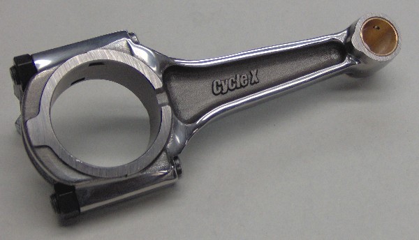

here is a link to the page http://www.cyclexchange.net/Superrods%20Page.htm
they sure do look cool

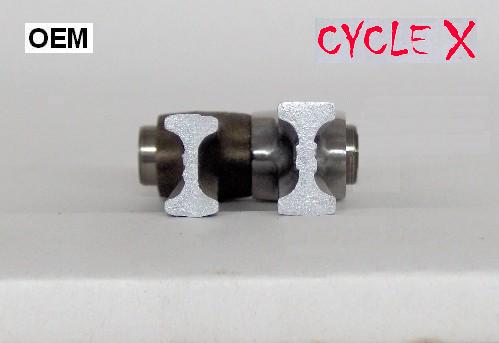

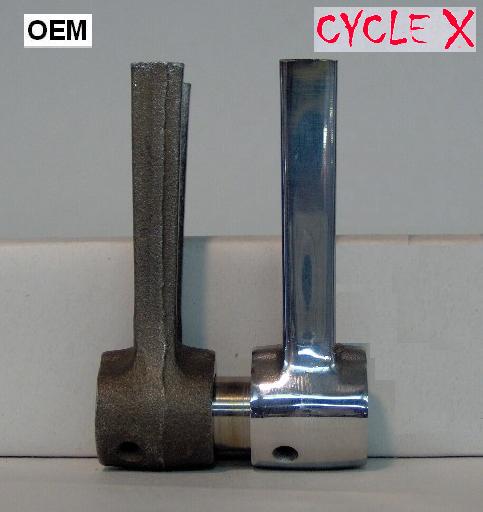

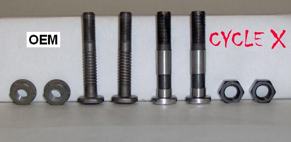

Here is the difference in the bolts
in these pics they do look a bit thicker
not sure how accurate all these are but here are they specs they give
DETAILS:
Stock Honda CB  rods..............375 grams ( Fluctuate in weight )
Super rods.............................. 372 grams
Forged from S45C and heat treated to HRC 23-28.
Small end bushings are Phosphor bronze.
Big end bolts are SCM435.
Torque spec is 30 foot pounds.
« Last Edit: April 26, 2011, 05:35:21 PM by orkid1989 »
“Experience is the name every one gives to their mistakes.” Oscar Wilde
