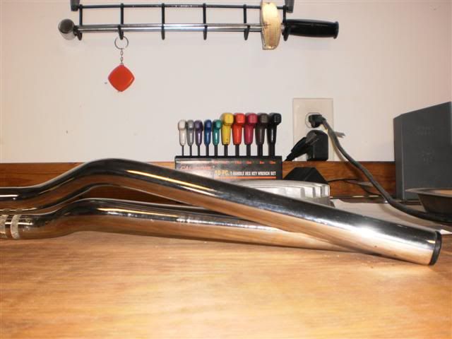

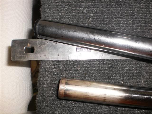

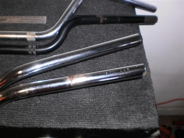

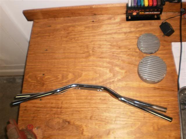

 Well, I took some pics but it's really hard to get a good comparison with the camera.
 I also took some measurements. The Super Bike measurements came from MikesXS's website, which is where I bought the bars.
 I'm not sure about the pull back measurement on the 400F bars, but they are definitely more forward than the SB bars.
 Super Bike
 Width - 30 1/2", Rise - 2 1/2", Pullback - 5 5/8"
 400F
 Width - 27 1/4", Rise 2", Pullback -3 5/8"
