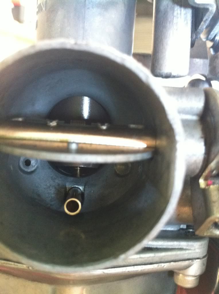

I have been completely rebuilding a new rack of 087a carbs that I finally found for my 1976 550k. Got everything clean and back together, and 2 days ago, had the slides lined up with just a hair of light shining thru.
I then got the spring mechanism back on, and somehow between 2 days ago and now, my slides are up between 1/8-1/4". I can seem to get the sync screws to lower them - they are at a point where they are all the way down. Idle screw is out, and not touching the plate.
I'm wondering if it's related to the fact that my throttle butterfly does not seem within spec distance of the stopper.  I can't push the butterfly any further toward the ground to make the slides get lower.
Any thoughts?

Are you measuring the cut out side or the long side. I believe you measure the long side (the engine side) of the slide. I use a 1/16" drill bit to bench sync so I get use of the my throttle idle screw.

OK, let's just get this straight.
A) I'm an idiot!
B) let's make that B too. I'm an idiot!
Sorry folks, I think the fumes from the Works in the tank got to my brain, despite taking safety precautions.
I checked it from the back side, it's at 1/16" bit height now. I know TT and Dave500 (thanks Dave!) like the slight light measurement. Maybe I'll try this, and then try that. I'm open.
My idle screw is still not in too far, but it is engaged. Is that OK?
Also, I moved the eccentric screw (what will they think of next?) so the butterfly is off the stop by about 2mm, which is spec.
Thanks folks.
