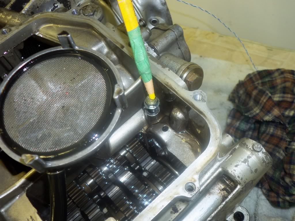

My Clymer manual stated in the steps of splitting the cases, you had to remove the rotor. WRONG If you are having trouble, stopped your progress because of this don't worry, you can carry on removing the bolts which hold the cases together.  Just make sure you remove the one that's under the oil pan

you will need to remove the rotor though to replace the main seal.
