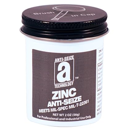

Thank you for this valuable info.
After some online ninja work, I have settled on the purchase of some ZINC ANTI-SEIZE that is a fraction of what Loctite charges for their primo version that comes in only 1 LB size.
2 OZ is probably more than what I'd need to coat on my CB550F engine case bolts.
"Corrosion protection up to 750°F (399°C)."

+1 on what Minimo said.  Lanocote is just lanolin, which probably works fine at temperatures under 100 degrees.  I suspect any oil, grease, or wax would work just as well... until you went through a couple of heat cycles and burn/melt/vaporize it off.
+1 on zinc.  I bought the expensive 1lb can of loctite zinc anti seize.  Good tip on the cheaper stuff Minimo.  I didn't see your post before I bought mine, but then again I have a lot of projects sitting in my garage so maybe it's a good thing I have a pound of it.
