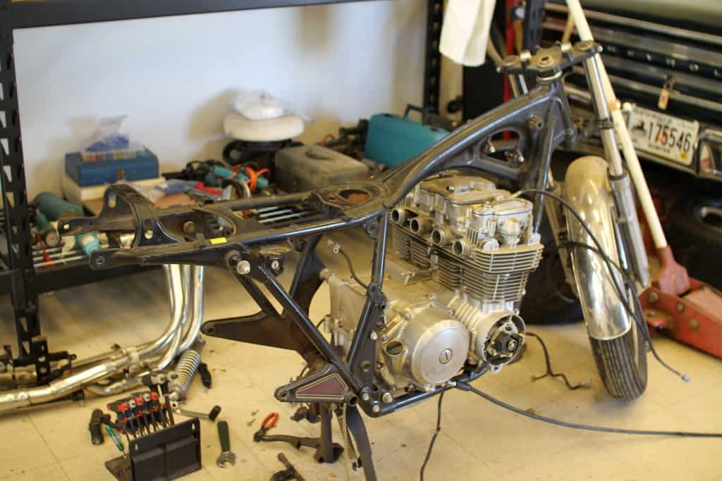

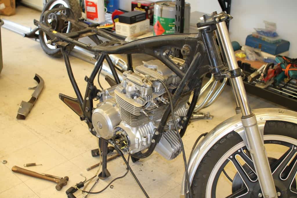

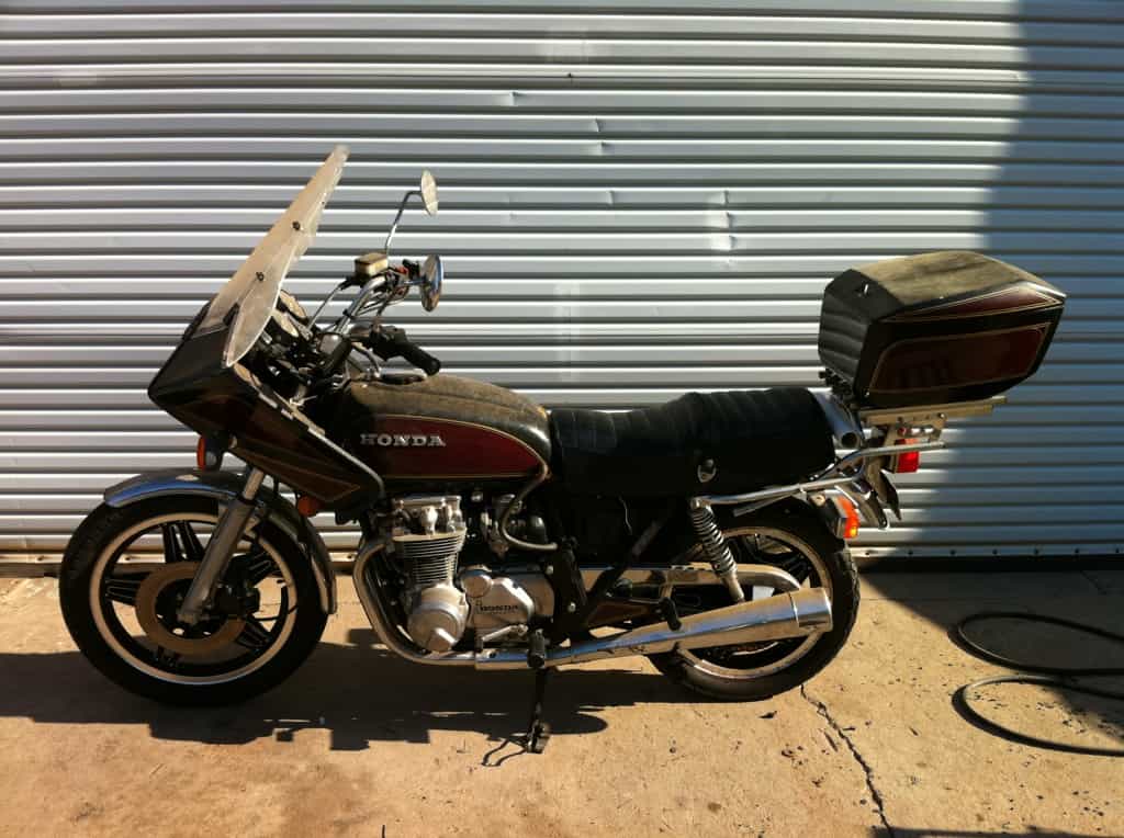

So here is what I picked up for $300. It was purchased locally and I am the 3rd owner. It had carb problems and was parked in 1998 in a garage and has been there ever since until I came upon it.
Bike getting stripped down:

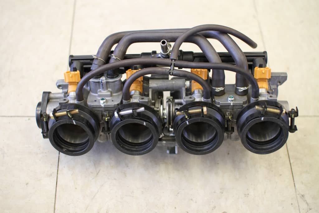

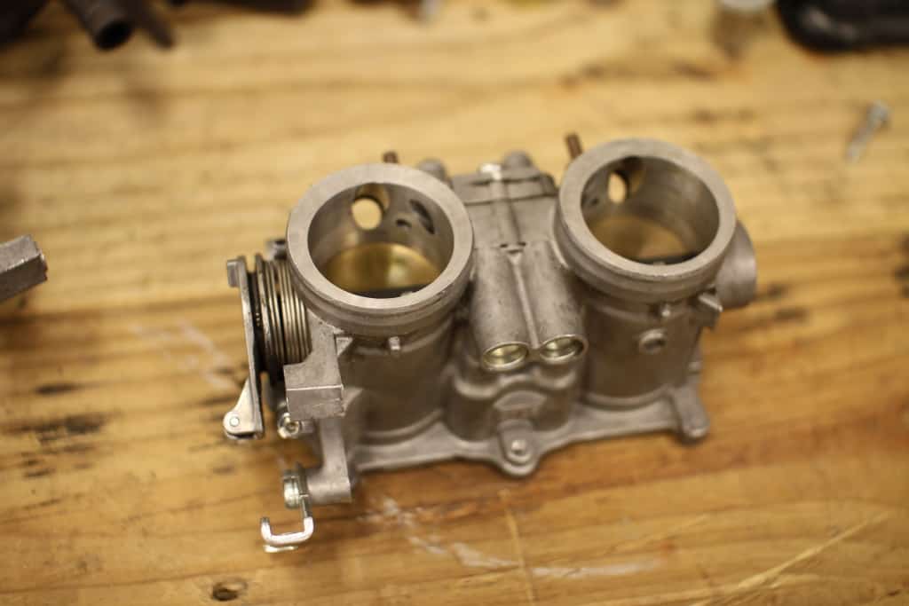

Throttle bodies:

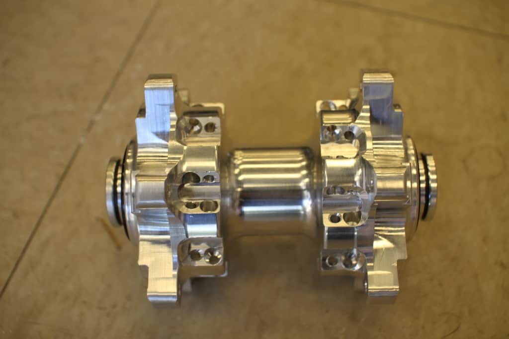

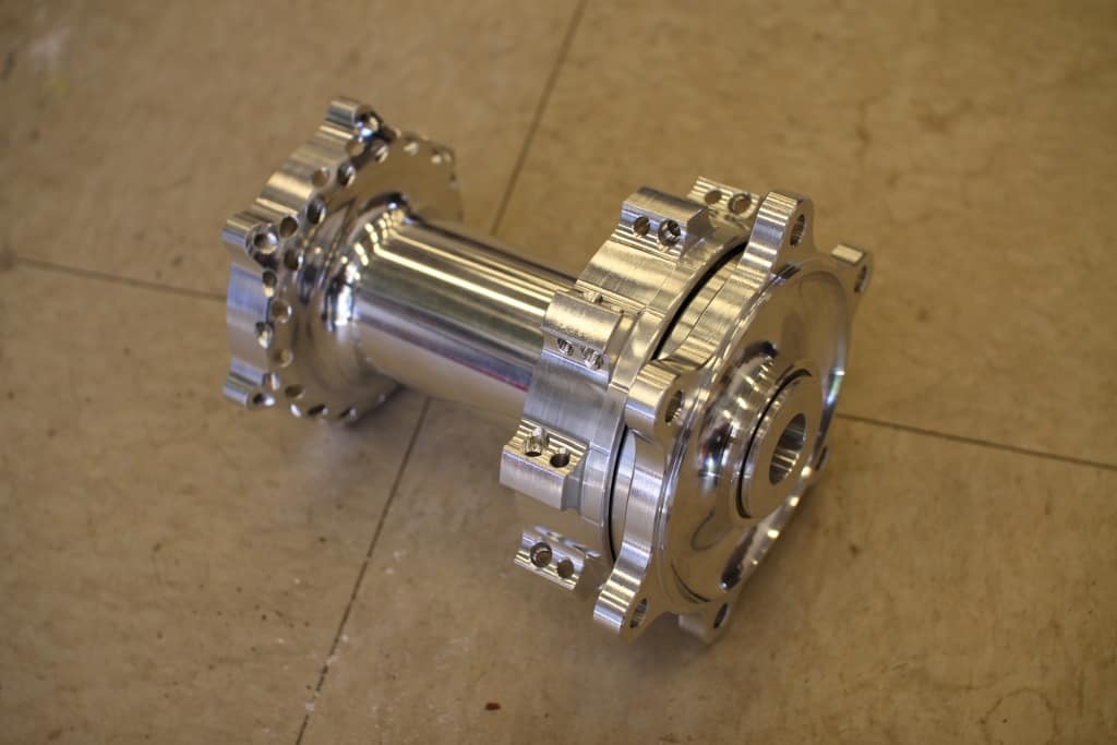

RAD rear cush drive billet hub before anodizing. I wanted to mock everything up then the hubs will be sent back for black anodizing, lacing, and truing.

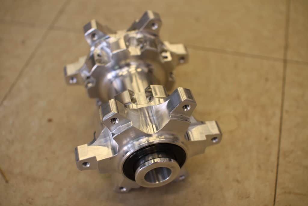

Front dual disc hub:

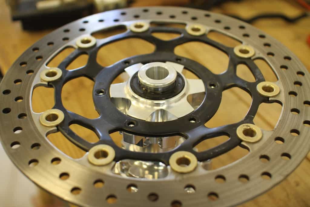

Hub with 600RR disc sitting in place:

Hi 65, nice collection of parts there mate. What is the spacing like on those throttle bodies? do they need alteration to fit.?

Thanks guys. I was really impressed with the hubs and think they are going to work really well. The front was setup for 01-06 600RR and was an off the shelf part so I will need to machine 4mm off of each rotor mounting surface to get the proper dimensions for the 08 front end. The rear hub I think is for a KTM 450 but I should be able to adapt it to work as well. This was much cheaper and quicker than getting custom hubs made.
The throttle bodies are really close to the correct spacing from 1 & 2 and 3 & 4. They might be 1 or 2 mm off at best but I have a solution for that I hope. They are a good bit too close between 2 & 3 but they can be separated in the middle so a couple of spacers and longer bolts will take care of that. The fuel rail will also need to be modified. It is comprised of a metal center section that has the fuel tank connection and each end has an o-ring fitting that fits into the plastic fuel rails that the injectors sit in. I will machine a new center section that is longer to make up for the spacing and this will also allow me to set it up for an AN fitting for the feed.  I will get pics of this tomorrow hopefully.
I plan on building an alloy fuel tank that will be placed inside the triangle and will have the fuel filler under the seat. The seat pan will be hinged so you can get to it easily. The stock tank will get the bottom cut out of it and become just a cover. I will place all the electronics under the tank cover so its easily accessible. This all comes from inspiration from my VROD and should lower the center of gravity of the bike.

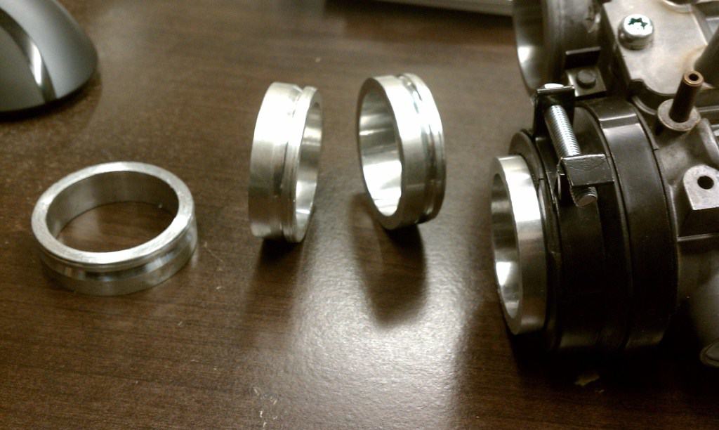

They will need a little work but it shouldn't be a big deal.
The 600RR throttle bodies have the following spacing:
74mm between each throttle body center to center 1 - 2 - 3 - 4
38.4 mm bore on head side
50mm outside diameter head side
The 79-80 650 head has the following spacing:
76mm between 1 - 2 and 3 - 4
81mm between 2 - 3
29.8mm bore on head
38mm outside of port on head
The 05-06 CBR 600RR insulator boots I have are 44mm on the head side and fit the 07-08 throttle bodies perfectly on the other side. So what I plan on doing is making a 44mm diameter ring with a 1mm offset 38mm bore on the inside. These will be TIG welded to the intake ports on the head. This will give me something to clamp the boots onto and will also correct the spacing on the throttle bodies for ports 1 -2 and 3 - 4. The insides will be ported out to blend in the transition.
To fix the spacing between 2 - 3 I will just need to make 2 7mm spacers and buy slightly longer bolts and bolt it back up. The fuel rail will get a new fitting in the center to make up for the additional 7mms as well and the stock portion of the rails will be used for the 1 - 2 and 3 - 4  throttle bodies since that spacing is not changing.
I'll add pictures when I get home. I'm at the shop now.

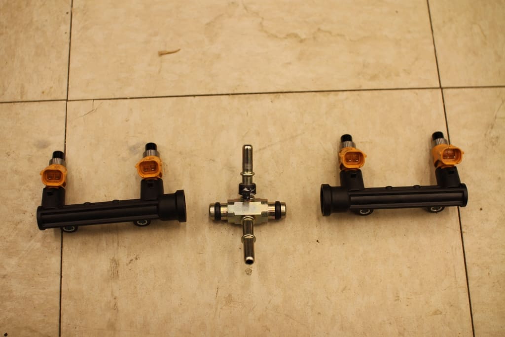

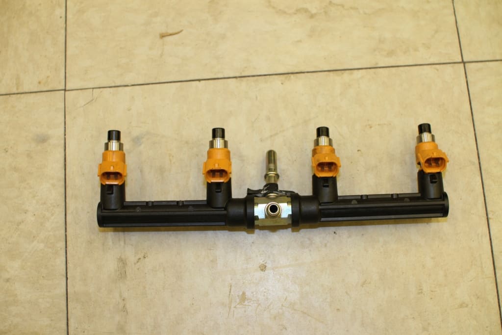

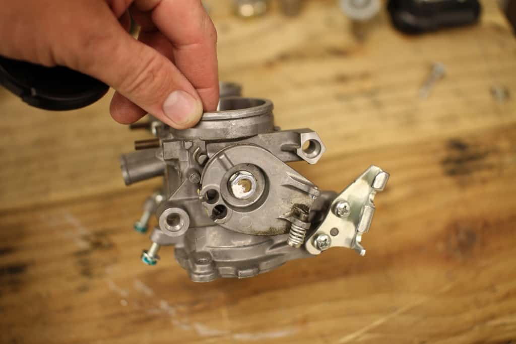

Here are the pics that show how the throttle bodies bolt together and how the fuel rail goes together.

RAD doesn't have any info on their site about RR parts.  What hubs are you using?
Offline 65Ch3v3LL3
  • Posts: 195
Re: 79 CB650 Cafe with modern upgrades
« Reply #24 on: November 30, 2011, 11:22:17 PM »
You have to call them. They don't list it on the web page. They do some custom work but its limited. The hub they have is for the 03-06 front end. Since I am running an 07-10 front end I will have to machine 4mm off of the rotor mounting blocks to make the rotors be in the correct position for the calipers. I haven't figured out the spacers yet because I didn't have the front end before I left for Afghan. I have the 07-10 front axle which is 20mm and I have an 03-06 front axle which is 22mm. I'll make one of them work or machine a new one. I like the RAD hubs because they use larger than stock bearings.
The rear hub is for a KTM but I don't remember off hand which one. The rear setup will be all custom anyhow since I'm using a GSXR swingarm and a CBR caliper on a KTM rotor. Should be fun to get that all mocked up. I plan on going to a 520 chain also. Fortunately there is a wide variety of sprockets available for the KTM hub so getting the correct tooth count won't be a problem.
Once I get home again and get everything mocked up I will detail all that is required to make this setup work.
RAD hubs have a really good reputation for being durable. Excel hubs not so much. I was impressed with the machining and the larger bearings. Should last for quite a while no more than I will use the bike.
On a side note I can say however that if you are looking for a super light wheel you really can't beat the stock CBR wheel. It is lighter than just the RAD hub by itself.
