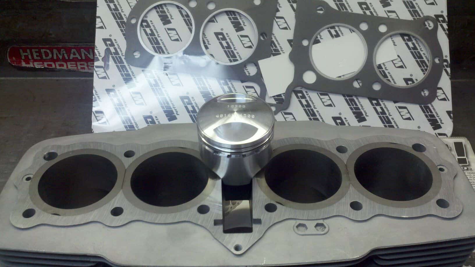

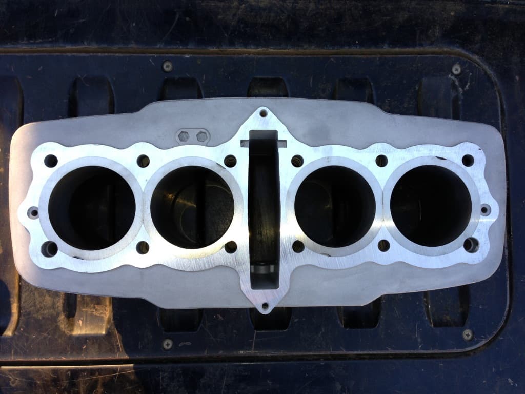

My buddy Ron that does the head work for Star sent me this pic the other day. My head is back after having the 750 sleeves machined to fit and bored to 65mm. Also in the shot is the Wiseco pistons we will be using. The gasket in the background came with the pistons so its for a 750 and won't be used.
As for head work he is going to port the head and install larger valves. Stock was intake 31.5 mm and exhaust 26mm. He is going to custom make some valves from blanks and increase the size to 32.5 mm intake and 28.5 mm on the exhaust. Apparently that is the largest you can go on the stock seats.

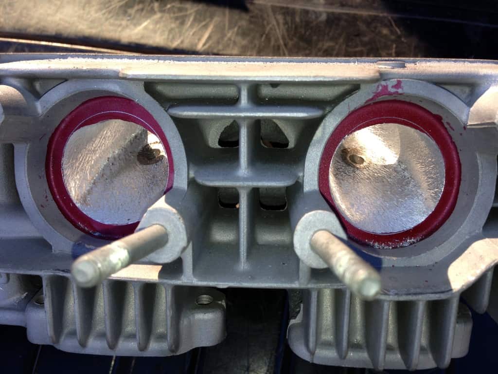

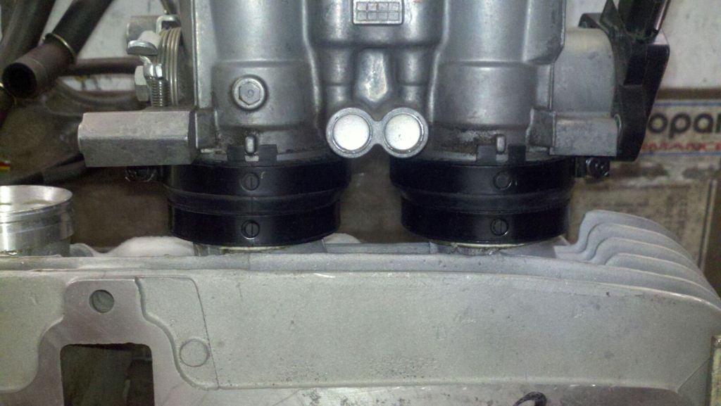

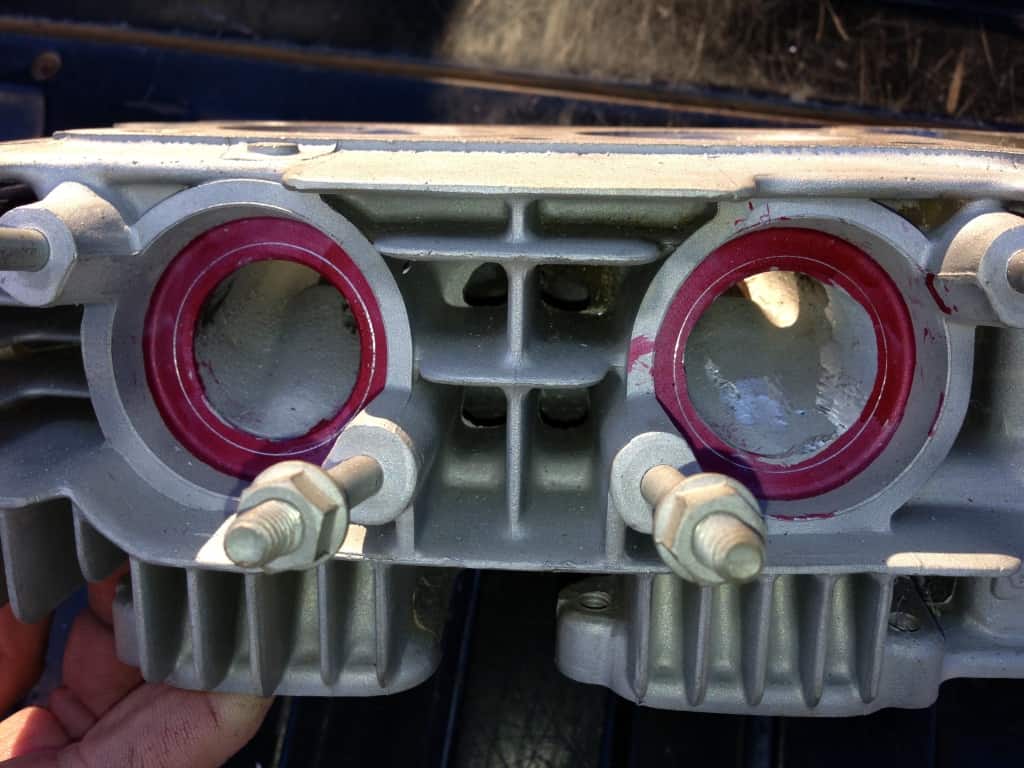

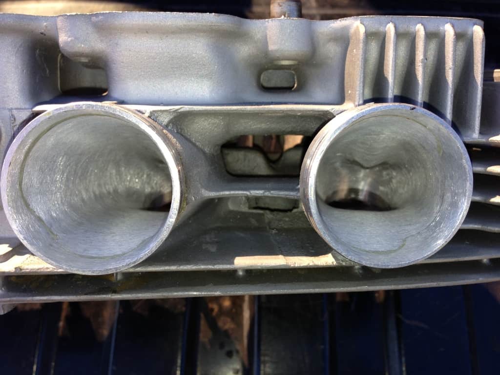

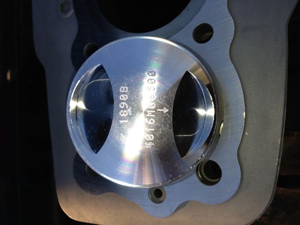

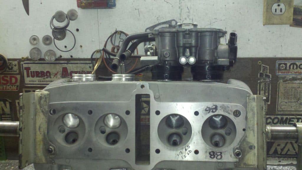

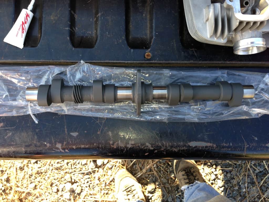

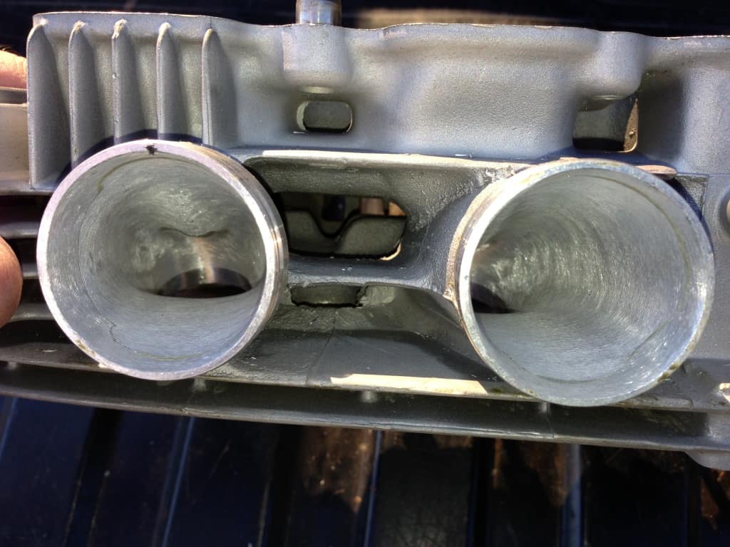

Well I made it home from Afghan for a short vacation but haven't had much time to work on the 650. I do however have some nice shots of the head work that is being done. Valve guides still need to be installed and the valves haven't been made yet. Also the chambers are going to be opened up for the larger pistons and the head needs to be surfaced. We are shooting for a 11.1 CR. My head guy thinks we are going to be in the 100hp range. Much more than I expected. I can't wait to get it on a dyno and see.
Exhaust port stock
Exhaust port opened up
Intake ports opened up with adapter rings epoxied on
Re-ground cam with more lift and duration
65mm bore CB750 sleeves installed
New pistons
600RR throttle bodies mounted to head

I can't beleive the TB's spacing is THAT PERFECT for the 650 head. I'm stoked on this build, I really want to do similar mods to my 650/836kit hybrid motor....my goal was always to try to break 100hp with it, I hope you set the bar!

The throttle bodies are pretty close. They are 1 or 2 mm off from the 650 spacing but the rubber boots allow for that much difference as you can see in the pics. The spacing in the middle is wider than the 600RR throttle bodies but its easy to make the spacers for it. So far its coming together really well. I'm pleased to say the least.

What are you using for pistons in the 65mm bore, are they stock Honda CB750?
