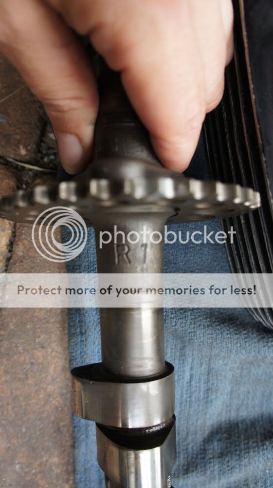

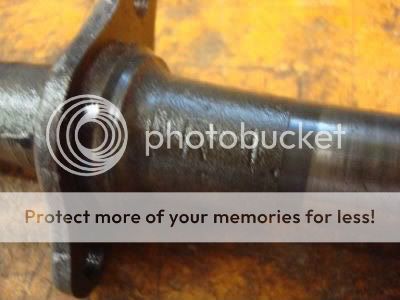

Those cam R numbers are interesting for sure and here‘s another clue for the CB750 cam detectives. One way to visually distinguish a desirable early production R1 cam from the later R1 cams is the orientation of the R1 mark. Note the differences between the vertical and horizontal placement of the R1 mark next to the cam sprocket in the examples below.
Early CB750 R1:
Late CB750 R1:
Disclaimer: This is from my own observations and not to be taken as gospel.  8)

That is interesting!  :D
Re: Cam difference
« Reply #12 on: November 07, 2011, 08:38:44 PM »
Dang it now we all have to go back and look at all our cams again !! Good observation on that John.
