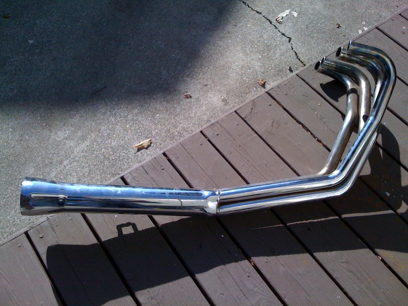

I know a bit about CB's but not much.  I got the engine moving, diesel fuel in the cylinders worked like a charm.  I have tons of work ahead of me, but, I'm really curious about the 4-1 that came with the bike.  Can anyone identify this for me?
It looks like this is gonna be one loud motherf$!%er, anyone have any info???
1973 CB750K

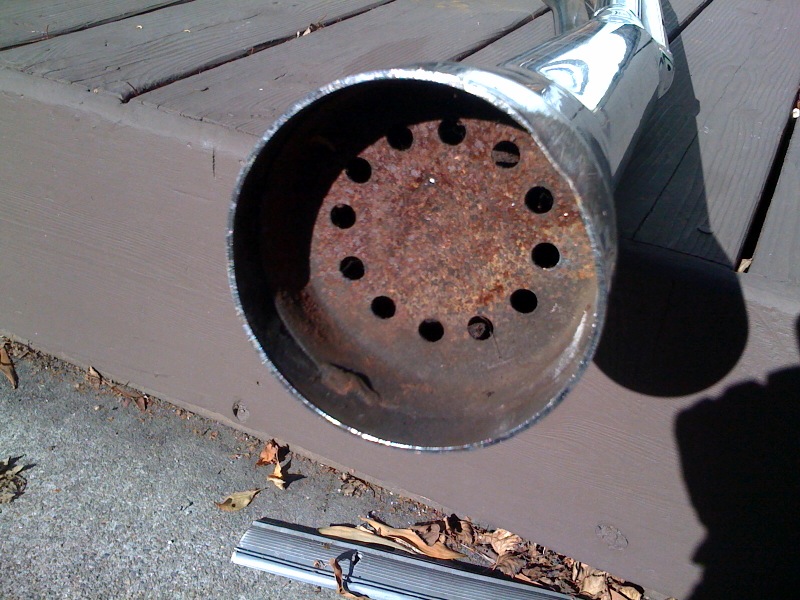

I am not sure what pipe that is but it will not be very loud or perform to well with that restrictive end plate welded in there....
Try member 754 {Frank}  for pipe identification

Agreed, it's probably going to be reasonably quite.  I would leave the end plate in place until you know what you want to do with the bike as a whole.  If everything else is relative stock, the back pressure provided by the plate will probably make it easier to get running fairly well.  Open the exhaust up and you will start off having to re-jet for the less restrictive open pipe.  Get it running with what you have first, you may be surprised.   Have no idea as to the maker of the pipe.

 Looks like a Jardine header...
