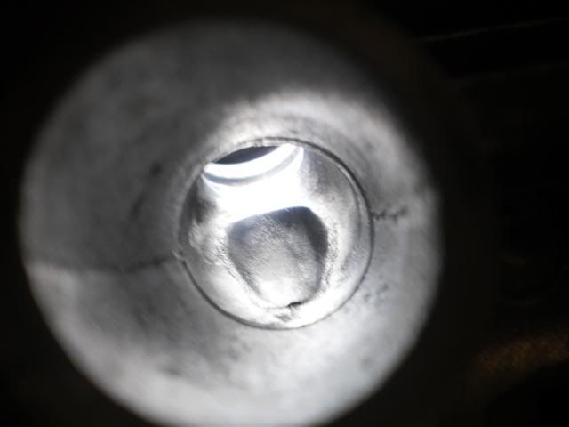

 Working on a '78 CB550. It's smoking a little, so I'm going inside it regardless. Been thinking about some mild port work to go along with the CB650 cam and a 1.00mm overbore.
 I bet I've read this thread a few dozen times, along with the Hondaman stuff in the FAQ's.
http://forums.sohc4.net/index.php?topic=17374.0
 Got a spare head, took it apart and cleaned it up in preparation for porting and was really surprised at what good shape it's in.
 Compared to the pics on that thread (and some others), I have virtually NO ledge at the valve seat. The intakes are nearly perfectly matched to the head (especially compared to the 550 engine that's currently on my stand. HUGE mismatch on those ports/manifolds). Even the casting marks and "boogers" aren't as bad as the pics in that thread.
 I'm really tempted to save my money and just install the cam and go.
 Maybe run a flapper wheel through the intake and ports just to take out the casting "boogers" but not remove any material or mess around with the valve guide "football".
 For a street ridden bike, is it really worth it? I don't want to move all the power UP by a few thousand RPM.
 I am very interested in the advanced timing mod. That keeps the power where I'd personally use it.
 However, will I need a degree wheel, etc., to do it right? Should I spend my time slotting the cam gear and figuring out how to get 3-5 degrees more timing and leave the ports alone?

Offline Scott S
  • Posts: 8,252
Re: Hi-Po mods: Are they REALLY worth it?
« Reply #5 on: November 24, 2011, 07:45:17 AM »
 Looking into the intake valve seat. Almost no ledge between the port and the seat like I've seen in other pics.

 What you're seeing in the pics of the manifold and ledge at the valve seat are mostly shadows. If I run my finger across the edge of either of them, I feel an almost imperceptible edge. Very, very close match on both of themright from the factory.
