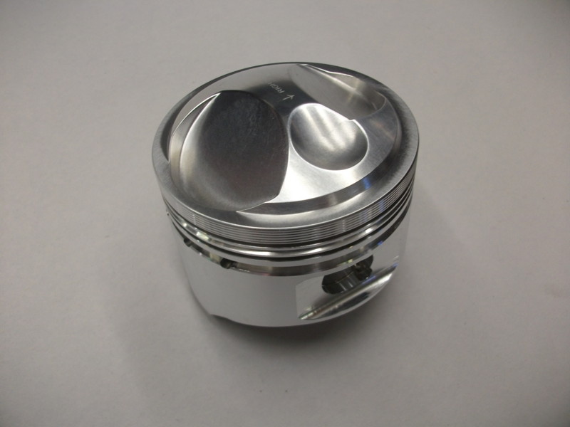

Just to be on the safe side I went ahead and ordered an 836cc kit off E-bay.
I would caution you against using the standard 836 kits in an F2 unless you are putting a different head on.  The F2's and F3's have a pretty significant dome to the pistons and, consequently the head.  The standard 836 kits, such as the Weisco kits, were designed for the 69 thru 76 engines that have VERY little dome to them.  If you use one of these kits with your F2 head, you will be sacrificing a LOT of compression!
Cycle X has an 836 kit specifically for the F2's and F3's that maintains the compression ratio.  It is a little pricey at $449, but it's the right thing to do.
Or you can go all out with this kit for $1049!!!
So the $110 kit off ebay is no bueno?

Those $110 kits will not work with a F2/3
I dont think that they work with the early Fs either

Some interesting info on piston compatibility here - http://forums.sohc4.net/index.php?topic=57528.msg703826#msg703826
Bikebandit.com lists the same part # for the 76 750f pistons as for the 77 750k pistons.
Quote from: gschuld on June 05, 2011, 08:44:36 pm
    Could someone give me an idea as to what compression ratio I would end up with if I used this kit(which I just ordered ;)) in a 76 cb750f engine?  It doesn't seem like it would be very high.  Any idea as to how much I can reasonably increase the CR with head milling, etc?
    Thanks
They come in at about 9.5:1 compression if you do not modify the head to add a quench band. If you add the quench band, it drops to about 9.25:1, depending on how much you taper the edges of the chamber. Don't forget: you are increasing the displacement by about 14% with these pistons, while the chamber remains the same as for the 736 engine.
The Wiseco pistons, with their domes, come in at an advertised 10.5:1 at 836cc, but that number presumes an untouched chamber. It makes for a lot of extra heat and a tendency to knock at low octanes, so the lower CR of these pistons is a good bet for trouble-free riding. ;) - Hondaman
Okay, threadjack over, thanks for the heads up on the piston issues. I'll post further piston questions in the thread about pistons.
