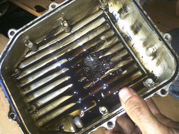

First I opened up the sump. Bummer:
Here's the problem!
Ok, needs a new primary chain.  Not too much of a surprise at 55k.  At least, it didn't go clean through that oil passage.

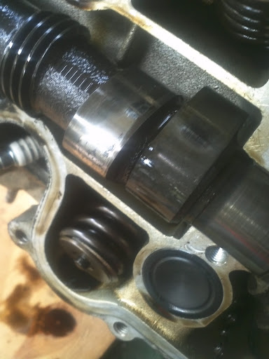

Open up the heads:
I think she needs a new cam.  A couple of the lobes have this pitting on them.  Another 500 or upgrade to the 650?

gday zojirushi,take a close look at the bottom of the cam chain tensioner,it looks like someone has miscued the well it suppossed to sit in,the drive hub can rub it when this happens,see how sloppy your primary is,it may have been replaced already?its been rebored so the top end has at least been apart,heres a photo of a wrongly installed tensioner.
Good information, Dave.  I haven't messed with the cam chain tensioner, but I know the PO put in a new cam chain.  This is the original primary chain, so I'll be replacing it.  Ordered a new one from David Silver Spares.  Also ordered a new cam chain tensioner blade.  I will have to refer to the service manual to get a better understanding of how it was miscued.  It may be more obvious to me once torn down and in front of me.

once you get it apart youll see how the lower end of the tensioner should go into a little square well,,you shouldnt be able to see the prong like ends of it once its in place,that might have been the rattle you heard as the chain will run slack.
