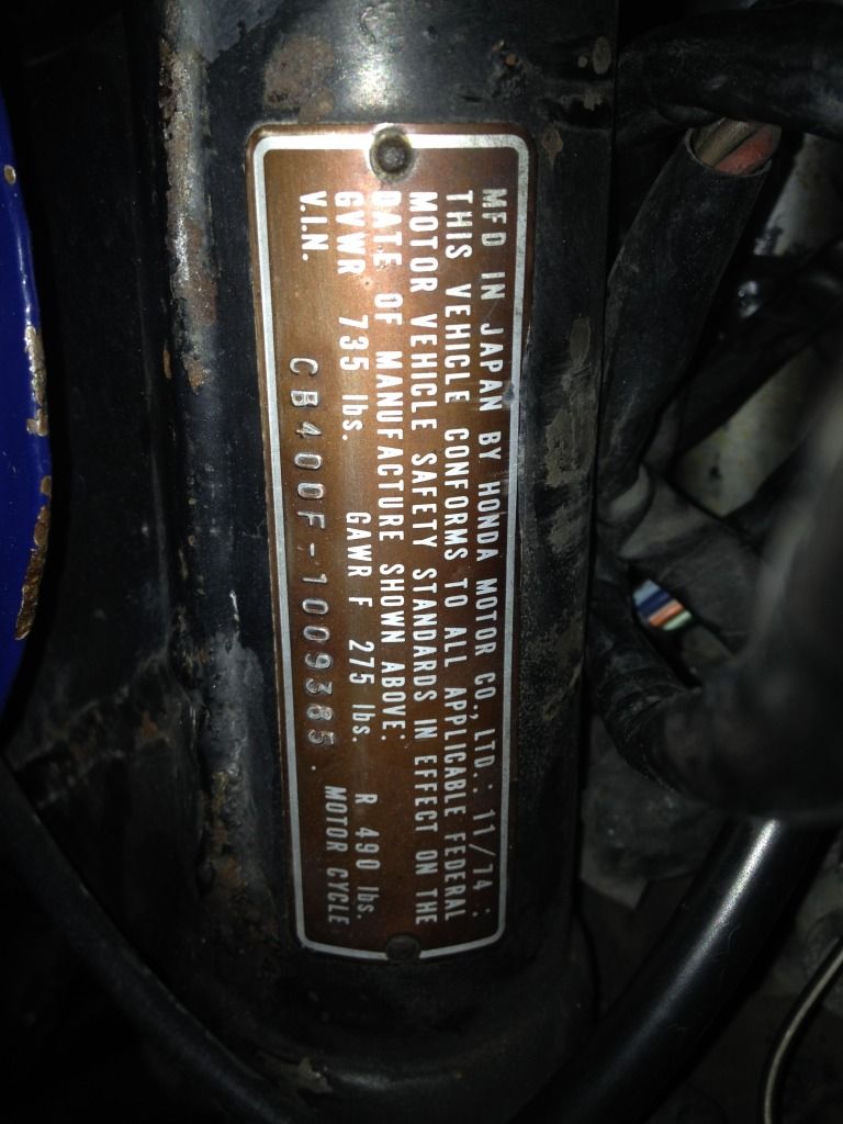

Question though: in the above photo, what is the black thing to the left? It has that thin metal attachment that connects to something else and I wasn't sure how delicate it was while removing the nut that was connecting the ground to the bike.

All you have to do with the beeper is unplug it. the wires should be covered if not cover them with tape. That black thing is your rear brake switch.

The "black thing to the left" is your rear brake light switch. Push down on your brake, you will see how it works.
