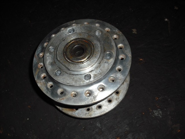

I found a listing on ebay that has the hub from a cb750 that looks identical to the hub on my spare front wheel.  The key notable thing is -- on the right side, the speedo drive side of the hub, there are two cuts on either side of the inner part of the hub normally covered up by the speedo drive I think.
Here's the photo from the ebay listing
My wheel's speedo drive side looks *exactly* like this ebay photo, with those cuts on the area where the speedo drive goes on.

See if this helps ...
The 750 front hub changes with frame number: CB750-1044650, the early / late hub differences are a bit more than just the hub alone. The following info should sort out the parts that you will need:
http://data.sohc4.net/SB750/750_26.pdf
In addition to the service bulletin, note the other associated part number changes that begin with frame number: CB750-1044650.

Thanks -- it looks like there's a 4mm thickness change in the front wheel hub starting with the 1044650 frame -- which happens to be the starting frame number for the 1971 K1 bike.
Thanks for that technical reference -- what that gives me is a way to find out if the wheel I have has a 4mm thicker 1969-70 hub.   However it doesn't exactly say which part of the hub is 4mm thicker, so I'm going to measure from the outermost surface (the axle area) on one side of the hub to the other, then compare.
I'll measure my known-good 1976 k6 hub off the k6 in the shop, then compare it to this spare wheel I got.  If I'm lucky, I have thinner hub that was used on the later k1, k2, ..., k6 cb750s.

All the 750 and 500/550 hubs had the two flats, they were the original drive flats for the first 750 speedo drive which is the one you want for a twin disc settup.
It was fairly late on that Honda decided to save a bit of machining time and money by not milling the flats any more.
The drive plate was changed by the way as the early one moved on the flats and caused needle "Flutter"
