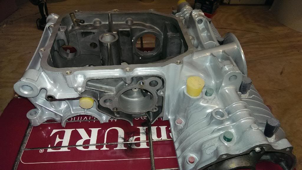

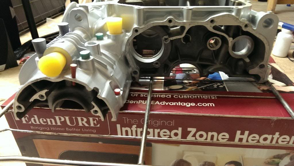

I then removed all the case bolts.  It took a bit, but I figured out that there was one long bolt under the oil pan.  Once I removed the pan, I found the offending bolt and the cases came apart pretty easily.
Cases Split
Top Case
Bottom Case
So, time to give a shout out to Brad Arnold of Arnold's Designs.  I sent him the Top End of the engine to him for Vapor Blasting.  I prepped everything with degreasing and then glass bead and soda Blasting.  I packed everything up and sent it off to him.  Within a week, I had it all back and MAN!!!!!  It looks fantastic!
Before:
After:

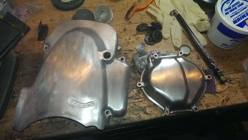

I still need to give them a final clean out to make sure there are no beads in the oil passages, but they look awesome!

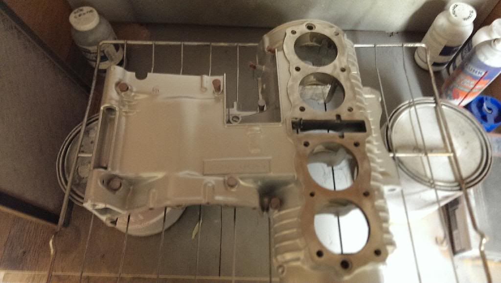

So, now that the top end looks so great, I wanted to make the cases look great as well.  I have the ability to powder coat and decided to test out a color I had chosen on the oil pan.  It is called Grey Aluminum (RAL 9007) from Powder By the Pound.  All went great, but it is not the right color…..  ALWAYS ASK FOR A SAMPLE.  The powder went on great, made a beautiful coat, but is way too grey for the cases.  I am having some other samples sent to me to choose an appropriate powder for the cases.
Anyway, here is how it went
I had Glass Beaded the pan after degreasing everything.  I then washed it in warm water to remove the soda and bead residue.  I then donned some Nitrile Gloves and used Brake Cleaner to remove any residual oils from the piece.  I then set my oven at 475 degrees and let the pan bake for about a half hour trying to maintain the pan itself at 450 degrees for 20 – 25 minutes.  This allows the part to bake off impurities that might otherwise degas while the powder is on the part, potentially ruining the powder coat results.  I then let the part cool, and while still wearing gloves, I used some Saran Wrap “Press ‘n Seal” to protect the gasket/O-ring surface.  I then gave it another blast of brake cleaner and let it evaporate off.
I then applied the Powder to the part using the Eastwood Gun at about 9 PSI.  You can see a really nice shine to the raw powder, and I was really looking forward to the end result.
I had let the oven cool to 400 Degrees, as the part needs to bake for 10 minutes after the pwder starts flowing (looks like liquid).  I lifted the pan by the wire handles and transferred it to the oven tray after pulling the Saran off the bottom of it.  Everything went perfect, but I am not happy with the color.
Here is the finished product:

The word "fantastic" doesn't do justice to those cases after vapor blasting! Purely Effin' Gorgeous came spurting out of my mouth.

The coat looks great, but on the cases it would be too grey, not enough polish.
The vibratory tumblers actually leave only a little residue which is easily blown out with compressed air.  On pieces with oil galleys and such I go after them with pipe cleaners and such as added protection.
So far everything has cleaned up beautifully.  I tried the boiling water on the carbs that I polished, not only did it make mud out of the media residue, but it marred the polished surfaces.  I redid them in a better media after cleaning them out and ultra sonic'd them after cleaning them.  I made sure no heat above body temp was present (ultrasonic cleaning creates heat) and everything worked out great.

We had some beautiful weather over the weekend, so I pulled out the buffer to go after the engine covers.  I had done a little wet sanding to the breather cover and sprocket cover as they has some deep scratches – Wow, I have no patience for wet sanding aluminum….
After a round of 400 and then 600 – where is my buffer? ???
Ahhh – that’s better!
I will have to back over these as there are still scratches visible in the light – but it had started raining and buffing indoors makes a bloody mess…  hmmm, even outdoors as well!  Anyway – here is where I started compared to almost finished
Calj – here is some more porn for you with a shiny cherry on top!
So – on to the monster…  Powder Coating the Engine Cases.  Earlier, I had thoroughly cleaned, blasted and re-cleaned, re-cleaned and you guessed it, re-cleaned again the cases.  After copious amounts of Brake Clean and compressed air, along with a soft pipe cleaner I am 99% confident that all the glass bead is out of the oil galleys, bolt holes and any other place the bead can hide.  I then put them back into a water bath and shot compressed air and water through everything checking the bottom of the tub for any grit.  Like the little ghost hunter in Poltergeist said, “This house is clean!”  Oh wait, she was wrong, wasn’t she?
So first up, I sprayed down the outer cases with brake clean, let it evaporate and then Baked everything for a half hour at 450 degrees.  I did this with the Oil Pan a few weeks prior so when I started this they were well cooled off (Ya’ Think?)
I again sprayed everything down with brake clean and dried it with compressed air.  I took the rack from my oven and set the bottom case on it after wrapping the rack with tin foil to keep the mating surface free from powder.  I used green painter’s tape and covered the areas I wanted to protect from the powder.
I covered what I wanted, and then traced the the outlines with a razor blade.  It would have been MUCH easier to use an X-Acto blade or scalpel.
In order to cover the oil filter mounting, I used the Filter Cover as a template.  It was a bit crowded to get the right shape of the mask on the Lower Cover itself, so this made it much easier,
Taped the cover opening, and cut out the inside for the shape
On the Case after cutting a relief in the middle for the bolt receiver which was then just covered up.
All set up and ready to go.  I covered the bolt holes to keep powder from getting inside the case.  At this point, I carefully sprayed brake clean over areas that I thought I might have touched during the masking process - the tape kept sticking to my gloves  >:(  - to make sure there was no oil or grease on the bare metal.  Be careful around the tape, but it will hold up even if you get a little Brake Clean on it.   ;)
Once I applied the powder, I carefully pulled the masking tape off making sure not to touch any powdered surface.  At this point, if you do, You will need to clean everything and replace any removed masking.  Basically, start from scratch.
Here is the uppercase after powder, but before removing the mask.  The color I am using is “Silver Speed Metallic” from www.powderbuythepound.com It applies white in uncooked form, but will transform in the oven.
In the oven.
I don’t know what happened here.  Its discolored, but very smooth so I am not sure it will be a problem down the road – and its underneath….
Uppercase masked:
Done:
