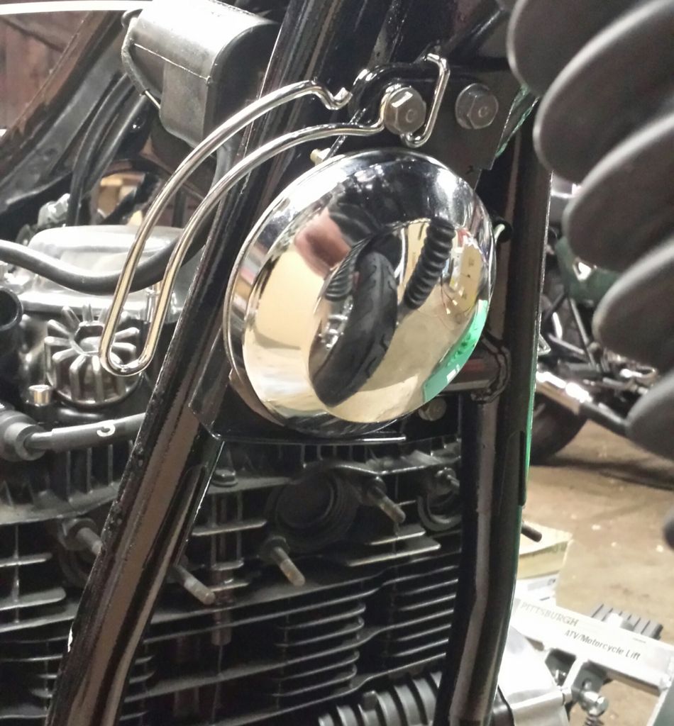

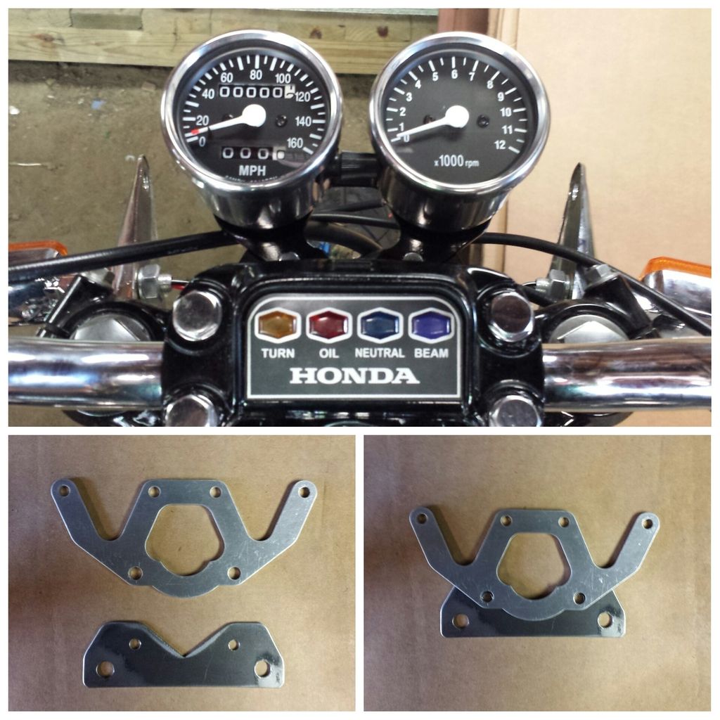

Few small updates. I got some mini-gauges and a mount from Dime City Cycles. The mount is made to bolt right onto later CB models so I had to fabricate a bracket (with my dad's help) to fit it onto my triple tree.
I think I've got the angle figured out for the right brake caliper, I'll try setting up just this one for a test to see if everything works right before I try both at once.
Lastly, I think I've replaced just about every piece of chrome that was on the bike. I love the look of these old horns, I found a used one in perfect condition and saved a heap.

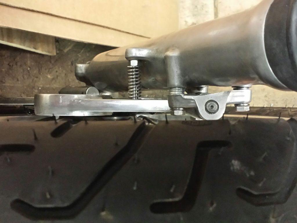

member Godfrey told me you do not need the long spring for the caliper bracket. if that is a problem remove it.

I don't think it will be an issue but thanks for the info Tews. The spring had close to no tension on it until I put the lock nut in. I had to run it on the opposite side to keep the caliper bracket in line. Now the spring has about the same snap back as the left hand side.
I've actually got Godffrey's speedo drive and I just grabbed a couple of his pistons too.

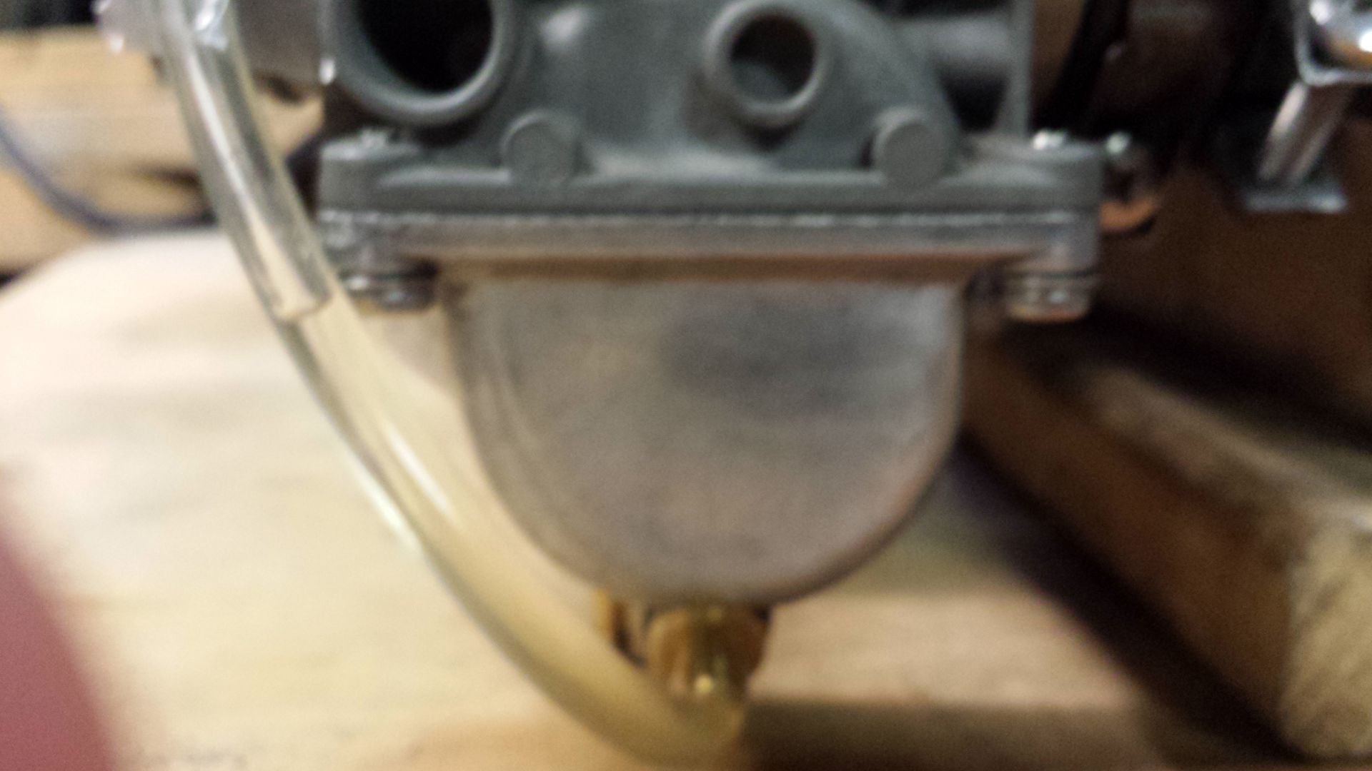

I ended up pulling my carbs off again, it was too tight trying to do anything with them on the bike. I made myself a float height gauge to set the floats at 22mm. They were all lower than they should have been by a few millimeters.
After setting the height I put them back together and did a clear tube test. They all look like they're roughly the same height now.
#1
#2
#3
#4
Seems to have fixed the leak from the overflow tube too.
Anyone have any opinion on how these look before I put them back on the bike?

I'll let more experienced eyes weigh in on 2-4 but 1 seems a lot lower than those. Or is it just the camera?
Offline onetruepunk87
  • Posts: 350
Re: 1972 CB500K - Resto-Mod
« Reply #145 on: June 19, 2015, 10:02:17 PM »
I think it's just the camera on that one but I'll double check it tomorrow to be sure. 2-4 are all close up and 1's from a little further away and slightly above so it's kind of deceiving.

Thanks for the input Chris and Cal, i remeasured the #1 carb on a more level surface and it looked pretty similar to the others. That was the only one that wasn't really plumb when I did it as you can see in the first picture from before (I spilled gas and then relocated for 2-4)
I bench sync'd them with a 1/8 drill bit and they were only slight off from each other and then I hooked them back up to the bike. I have a vacuum gauge I can use to dial them in later.
Everything seems to be good now, no leaks or overflow at all. I don't know why I didn't do this in the first place, it would have saved me the hassle of disconnecting everything.

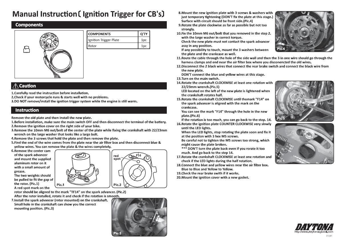

Switched out my points and condensers for an electronic ignition. This was incredibly easy to install, completely plug and play. It's a Daytona Ignition, It plugs in to the same spot as the old points plate wires plus one wire that piggy backs on to the rear brake switch's black wire.
