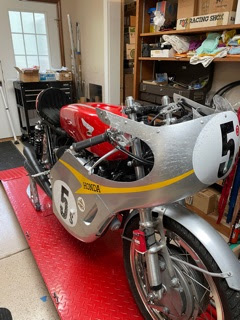

On my wish list was a full fairing.  I had purchased an RC181 fairing from Moto Forza many years ago, but found it was much to narrow for a CB550.  With my now slimmer motor I gave it a second look and found it was still about 1 1/2 " too narrow.  I could not see any way to narrow the motor more, so decided to try widening the fairing.  I sectioned it down the middle and added an 1 1/2" extension to the nose.  From past experience I knew the curve side to side and top to bottom had to be maintained for both appearance and to ensure the windscreen fit properly.  I think it turned out pretty good.  Here is the finished result after paint.

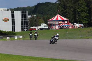

Another racing season in the books.  Barber was an up and down (literally) event for me.  The weather was a much better than last year.  Other than a damp track Thursday morning it was nothing but sunshine and warm temperatures all week.  Practice went well and in the last session Friday I found some guys to chase and got into the low 1:52's.  First race Saturday was Formula 750, my bump class.  Got a good start from row 2 and was with the lead group into turn one.  The class of the field this year was Tripps Noble on an XR750 in a roadrace frame.  Following Tripps was Mark Morrow on his RD400, Kenny Cummings on a 750 Norton, and Brad Phillips.  Couldn't quite run with these guys, but did get into the 1:51's to finish 5th.
Barber Museum and Wall of Death in the Fan Zone.
With a one race break it was back out for the Formula 500 race.  With another good start I found myself in 3rd in turn one.  Was able to pass Eric Lukehart on his RD400 and chased Mark Morrow home for a 2nd place.  Improved my lap times with a best in the 1:50's.

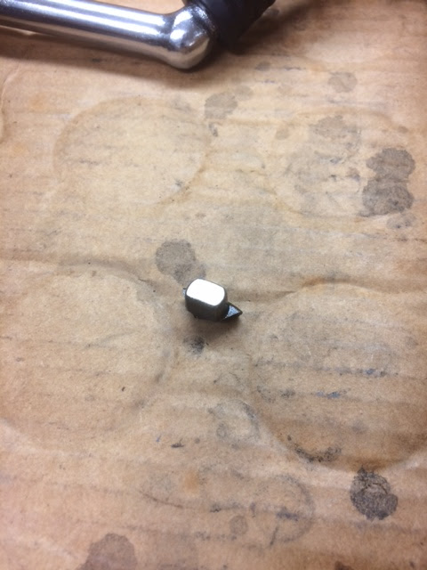

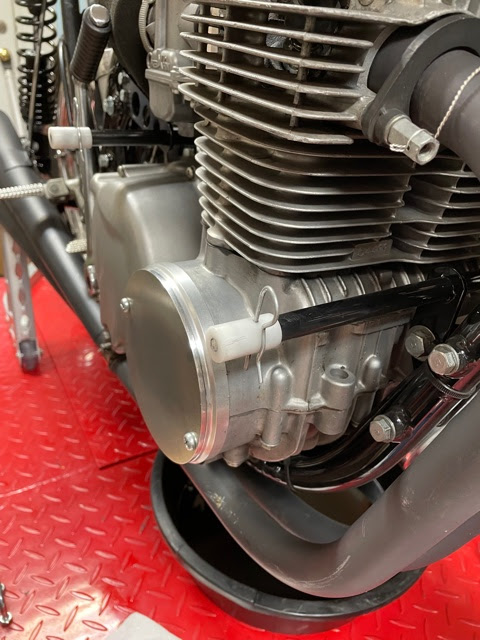

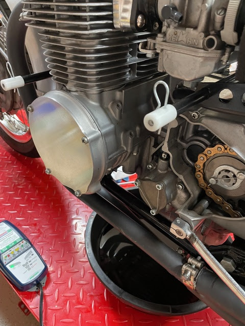

Following my normal oil change routine I changed the oil on Wednesday.  Much to my horror I found metal on the drain plug magnet!  Definitely gear metal.  Pulling the oil pan confirmed there were broken gears in the box.  A shift dog had broken off second/third gear and the other two dogs were cracked!  I'm wondering if the hard welding and race cut is the reason.  With one week before leaving for AMA Vintage days the wrenches were flying.  Pulled the motor and removed the lower case.  Not only was second/third missing a dog, but the fragment had gone through the fourth gear set.  Fortunately the custom first and fifth were not damaged.  A used motor bought for parts was then torn down to source donor gears.  The motor was reassembled with a mix of stock and race cut gears, male and female.  Fingers crossed, just need it to hold together for Mid-Ohio as there is a gap in my schedule for a proper rebuild afterward.
We set up in the Mid-Ohio paddock Thursday and prepared for practice Friday.  Much to my relief the transmission shifted just fine and made it through to Sunday.  For the first time this year I had a working front brake and was riding decently.  Saturday and Sunday finishes are averaged for your overall finishing position.  I finished second in Vintage 3 both days having a spirited race with a Yamaha 650 that was bored to 750.  I was faster on the first half of the track (including the main straight) and he was faster on the second half of the track.  For the first time ever I ran away with both Formula 500 races.  It was such a strange, but good, feeling to win by over 10 seconds both days.
