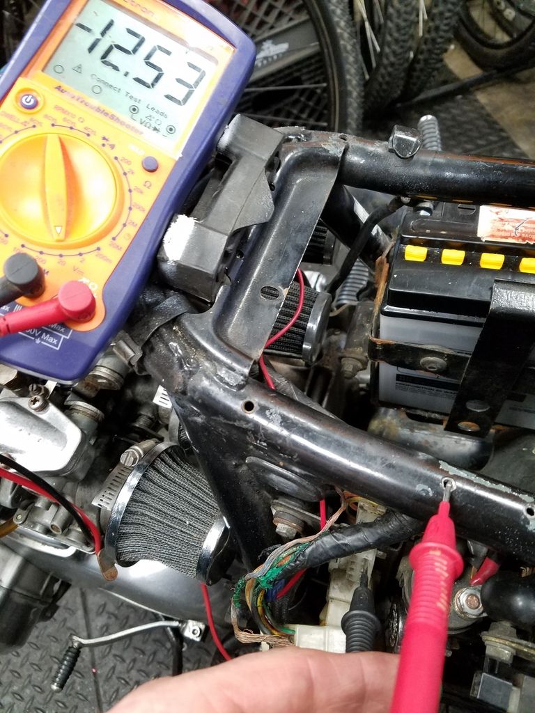

« Reply #6 on: March 13, 2018, 04:12:28 PM »
A photo of the offending wire.

« Reply #7 on: March 13, 2018, 06:49:10 PM »
Green (toasted) wire is showing positive current when battery is connected. That's bad, right?
Also found a similar condition of meltiness in the headlight bucket where the right hand green ground wire attaches to the headlight bucket ear.

« Reply #8 on: March 13, 2018, 07:01:53 PM »
Matt, just for grins measure from the frame to the battery - terminal.
Offline fatmatt650

« Reply #9 on: March 13, 2018, 07:03:50 PM »
0.00

« Reply #10 on: March 13, 2018, 07:13:07 PM »
The rectifier is likely shorted, and was probably caused by reversing the battery polarity, as Lloyd said. You may be able to repair the harness, but you will have to unwrap it to make sure the insulation wasn't melted through on the other wires in the harness.

« Reply #11 on: March 13, 2018, 07:16:50 PM »
I'll see if I can figure out a diagnostic for that, thanks. I did just notice I'm reading 12.5 volts at all three connections to the regulator. That seems odd.

« Reply #12 on: March 13, 2018, 07:22:45 PM »
Is that with the key on?

« Reply #13 on: March 13, 2018, 07:29:53 PM »
Yes. I pulled the green wire from the rectifier and it now no longer reads positive charge at the various green wires. Brake, oil and neutral lights all work now. Still a very mild blue spark when I connect the battery terminals but not as bad as it was. Here's the weird one - I pulled a spark plug to check for spark (crossing the solenoid terminals as the starter switch is not functioning), no spark, the turn signals have been removed but I flicked the switch anyway and when I did the spark plug sparked.

« Reply #14 on: March 13, 2018, 07:36:50 PM »
P.O. had connected the gray and black wires at the turn signal directly to each other, when I saw this I disconnected them. After seeing the weird spark issue, I reconnected them and it now has good spark.

« Reply #15 on: March 13, 2018, 07:40:17 PM »
Do you still get a spark when connecting the battery? If the key is off when connecting, it's a problem. If the key is on, it's normal. ;)
