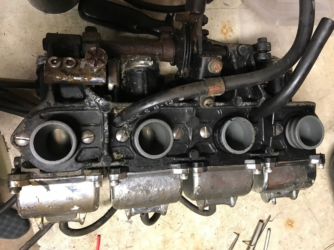

I've had stainless steel engine bolts fitted since 1979, still fitted, no problems whatsoever except when first fitting the rear lower engine bolt on my 500. It's the step bar bolt and I decided to use stainless steel nyloc nuts on this custom made rod. Went together no problem, however when I needed to undo the nuts they were welded on solid, used a blow torch to melt the nylon part thinking it may be the problem, no difference. In the end I had an 1/2" T bar with a scaffolding pole attached for extra leverage, I felt it start to move and then the rod itself sheared off just behind the nut. I complained to the manufacturer of the rod and nuts and they said I should have used copperslip grease, which they failed to mention beforehand and at that time using stainless steel on bikes wasn't exactly popular or cheap so I didn't know about the galling thing. He made me a new rod FOC and supplied 2 normal nuts instead of nyloc, never been a problem since.
The bike sat for over 40 years in a garage, on top of the bike were 2 rolls of loft insulation to disguise the bike in case the garage was broken into, rats got in, made a nest in the insulation and proceeded to pee all over my bike for around 15 years, the only bolts to really survive this treatment on the carbs were the stainless ones, all the rest were very rusty. Worth every penny I spent on them.
Ever see a throttle linkage bar this rusty?
