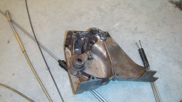

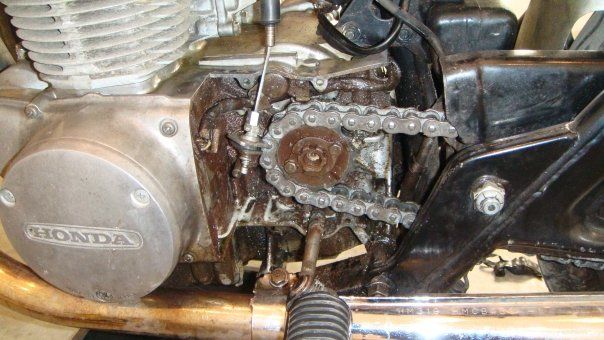

OK, its been a while.....
I have been futzing about with the bike, but garage construction and life have seriously eaten into progress.  As I got deeper into the bike, I realized how much is needed due to a PO not being quite diligent in the care of this bike.  i know some of you can relate........
In an attempt to Synch the Carbs, I realized the throttle cable is completely toasted, and getting a new one has been a little frustrating.  The 450 has a cable that splits into two cables as it gets towards the Carbs.  I found one that did not fit after the split, even though it was advertised as a stock cable.  However, I will deal with that Ebay Seller after I confirm that it does not match the other "stock" cable I got from Crotchrocket.com.
As a positive Ebay experience, I found and scored a RH 1968 Side Cover.  Can I just say.....  HUGE!!!!!!!!!!!
This past weekend I had the honor of realizing just how good an Impact Driver is.  I replaced all the soft Phillips head bolts with beautiful Stainless Allen Heads on the left hand side.  I could totally understand how the original bolts could strip, and with the Impact Driver I got the originals out with a little hammering (and PB Blaster) and no headaches!  Get one in your tool box NOW!!!!!!!
I did have an issue with the PO leaving a hex bolt in a very inconvenient place.  How he was able to get it tight is still a mystery to me.  I was able to get it out after Drilling, attempting to cut a slot for a screwdriver, etc.  By luck, I was able to get it out using a normal 10cm wrench, but I don't understand how....
anyways...  here are some pics...
the hex nut before removal
Getting naked...
This was nasty...  I have cleaned it pretty well.  The Seals were very loose in their seats.  I pushed them in, and I am hoping they will stay....  and not leak.  The Seals were at the Clutch activator input rod and at the shifter rod.
I pulled the sprocket cover apart, cleaned and re-greased everything.  It  gave me a good idea of how the clutch is engaged and released.
So, stupid question.  If I want to replace the grease zerk for the clutch actuator...  how do I do it?  I know its been done for the swing arm.  What kind of grease gun should I be looking for if I don't replace it?

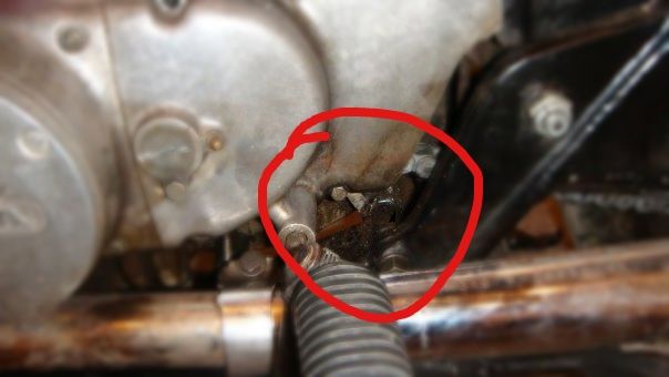

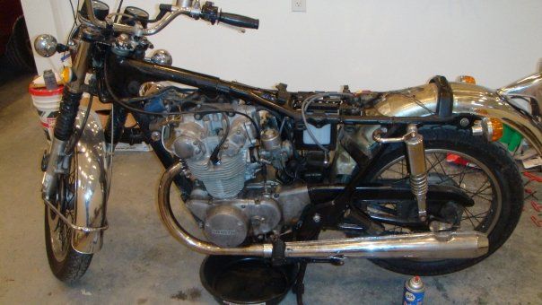

Offline dagersh
  • Posts: 1,010
    • Photos
Re: 1972 CB450 "Supersport" .....Honda, but not SOHC, and not a four
« Reply #14 on: October 20, 2008, 02:48:19 PM »
Thanks Guys!
HM - I will do some research and see if I can find anything.  Like I said, I am not married to them, just like the Bling!
As promised, more photos!
I was able to work a bit on the bike and finished installing the SS Bolts.  Lots of anti-seize was used!  I had to remove the Head pipes and mufflers as a unit as I think age has locked that joint for all eternity!
Also, the PO has neglected to reinstall a couple of gaskets - specifically the alternator gasket on the LH side, so there is a small, but persistent drip coming from there.  However, considering that the bolts around the sprocket cover were missing, and the bike completely pissed oil every time the clutch lever was squeezed, it does not mark its territory that much anymore!
RH (Clutch) Side cover SS Bolts
LH SS Bolts and oil leak from the alternator cover
PITA Header Muffler joint!  Heat and PB did nothing...  Ah well, BCR units are in the future.
Patience and Persistence got the RH K&N Back on tight.  It did not look like it would be such a struggle...
Another view - anyone want to comment on my fuel hose routing?  It seems to work, but I have not put a lot of miles on yet.....
New Throttle Cable installed - ONLY USE HONDA CABLES!!!  Or at least be real positive of your measurements!  Ask me how I know!
Coming together nicely!  Never mind the clutter!
Money Shot!
Finally - the elusive RH Side cover has been located and received!!!!!
I now want to work on adapting the seat to the hinges on the frame.  If that does not work, I think I will just go with HD Velcro.  But I think it would be a fun and educational mod.  Also, I want to trim the rear fender a bit and replace the taillight unit with a early '70's Moto Guzzi Round unit that will look much less bulky.
When I am able to finish up my shop space, I will start the disassembly of the bike for cosmetic restoration as I am really pleased with the system functions and overall performance of the bike.
