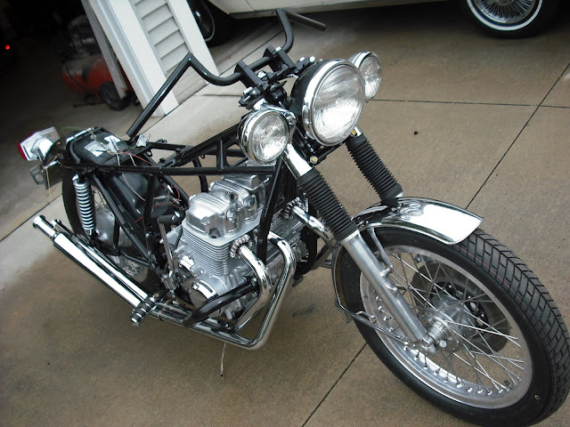

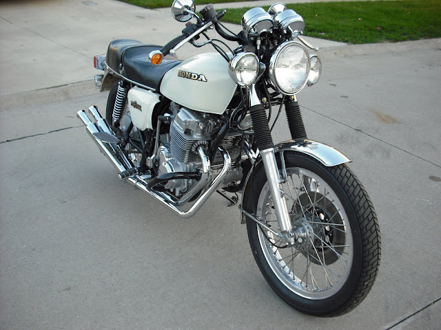

Gene's (grwmotocycles) got a great looking bike.  He's asked me to post some pics.  I'll document the process for others to use "my method" ;)

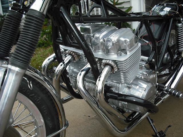

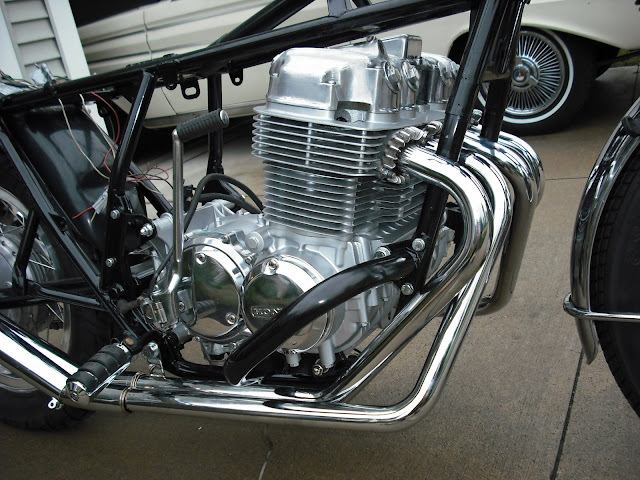

I love the black engine guards.  Were those chrome guards originally?  If they were chrome, how did you prep the surface?  Great looking bike!!
K6
K7
Suzuki GN400 - Ignition fixed!
03 KLR650 - Doesn't do anything very well but.. well.. does everything.
Offline grwmotocycles
  • Posts: 93
Re: Cool Blue Pipes!
« Reply #17 on: December 09, 2008, 04:22:25 AM »
They were chrome and most of it was peeling. Just Used a D/A to rough up then paint.  I figured even if the only last a couple seasons they come off easy to paint.

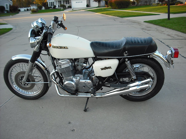

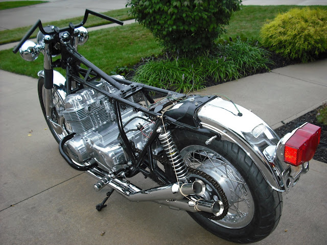

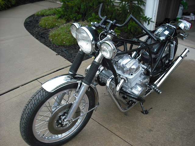

Great photos and very unique looking bike - very nice! More details on the exhaust please....and I agree about the black engine guards -nice touch.
One question though - the carb rack looks as though its bent down or no vertical -is that correct and is there a reason for it? Like tank clearance?
cheers
Andy
  • Posts: 93
« Reply #20 on: December 09, 2008, 10:40:26 AM »

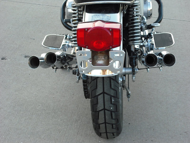

you are right, the carbs were just hanging there I pushed them on real quick cause it was a nice day for pictures.  Also you can see the  Left side cover is loose cause the paint was still curing and I did not want to push on too tight.  They have been properly secured now.  The pipes are Mac drag pipes which I had to enlarge the hole that connects the two pipes together  at the underside mount so I could have enough clearance to spread them a little to install the muffler flanges.  At the time I could not find Paucho up swept pipes (which are available now) so I used an old set of Triumph pipes and cut a short piece of the bend to kick the pipe up and installed between the header and muffler.  The drag pipes were shortened to two different lengths to move the mufflers back/forward to be able to see the 2 separate mufflers on each side so they were not exactly next to each other. Way to much time and money in the exhaust!

Thanks Gene great info and I really like the upswept look of the pipes so money well spent!
I also like the white - although Id personally add a tank stripe to break it up or even some pinstriping. Sharp looking bike and clearly a lot of work gone into it.

Where did you get the foot pegs?
knock with no answer
  • Posts: 93
« Reply #24 on: December 09, 2008, 04:11:06 PM »
void909
Foot pegs are from Jirehcycle.com a harley/shovelhead supplier I have use for years on earlier shovelhead/ironhead projects.  I had to install a bushing next to the peg mount where the pin slides in which a bushing can be made or I just used a stainless nut to take up the space.   Geno
