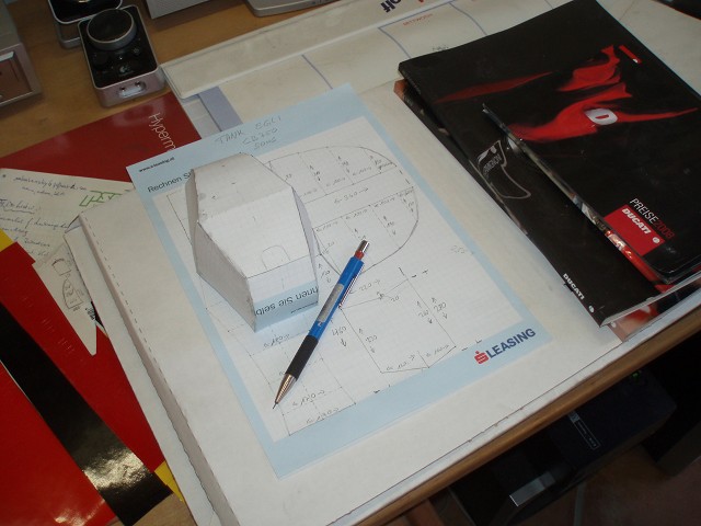

I am planning to make an aluminium fuel tank for my friends (peter) sohc egli. it seems that peter lacks a little bit on height compared to his weight (hoping he does not read this letters). his recent alu fuel tank does not suit his demands at all. so we will try to fabricate a better shaped tank.
here we have done a 1:4 scale papertank (I am sure this one will fit his figure very well):
mec

So, I'll just give up on the dream then? I think the curved decal is much improved. I personally prefer the number decal on the left side- primarily black. I think it compliments the "Egli" logos.
And we (I) await impatiently for the documentation of your tank construction. ;D

Alloy tank? Woohoo! Cheers, Terry. ;D

I started the work on the alumminium gas tank project, pics will follow in another thread
