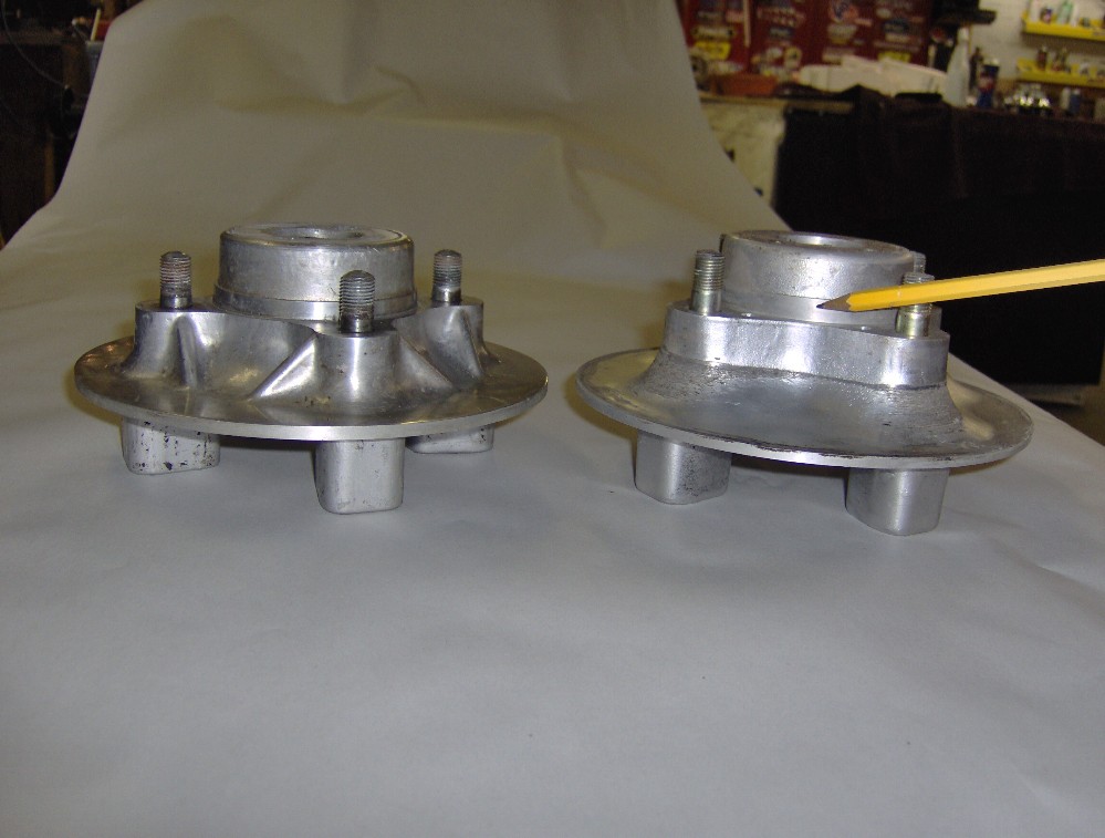

« Reply #6 on: September 07, 2009, 05:46:50 AM »
F series 750's had the chain running 10mm further away from the engine/tire than on the earlier bikes.  Different output shaft, and wider rear sprocket carrier at the rear wheel.  You should use an earlier rear sprocket carrier in order to have proper chain alignment.
Go to the Cycle Exchange website to the Honda 750 page and scroll down about 2/3 of the way for some pics and info about the sprocket carriers.
http://www.cyclexchange.net/Honda%20Page.htm
