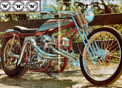

 I think back in the 80s Billy Budde had 750s with out the oil tank.. and the coolest, and I do mean THE..coolest custom pipes you could have imagined..
  • Posts: 19,235
Re: Irradicating the oil tank.
« Reply #46 on: November 05, 2010, 07:57:56 PM »
Got any pics Frank.? I would love to see that...

Try a search for Billy Budde Customs in San Leandro..
 His stuff was often in Street Chopper, later he did some H-D stuff.
 Pretty clever fellow, he ran  stuff like cams in 750 to fire  both pistons at once, and he built and offered fuel injection for H-Ds back in the 80s or early 90s.
 His shop was very near Arlen Ness, when I went there once I thin I tried to find Billy.. I think the shop was closed.. or something..
Is this it? (click for larger)

« Reply #49 on: November 06, 2010, 06:26:16 AM »
I'm interested in this - I hate the look of that oil tank.
It would not be hard (and maybe not that expensive) to have a nice sheetmetal oil pan made up so you could have whatever shape and volume you want.  Just don't know enough about hydraulics in general and oiling systems in particular to know how much that buys you.
