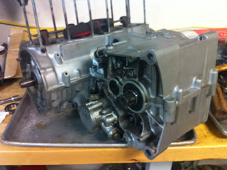

both engines were pretty nasty
engine completely torn down and cases media blasted and painted
new pistons and rings. cylinder done .25mm over stock
also new cam chain and tensioner... everything sealed up

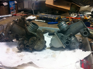

carbs were crapy
now not as crappy

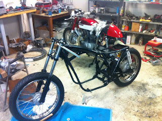

frame stripped/blasted/welded/ground/ and painted with por-15 hardnose paint
forks rebuilt and painted

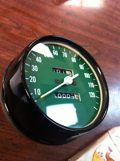

speedo rebuilt

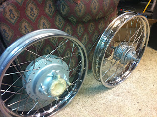

wheels rebuilt with new stainless spokes and rims (wish i had a close up pic of the easy rider chopper wheel it had on the back.. nasty)
