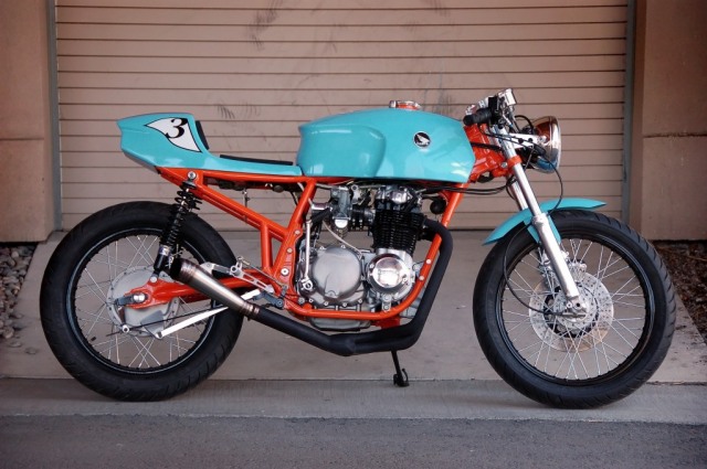

Haha, well your "inspiration" is a little out of date now!  Here ya go:
And with the clear ignition cover and Anti-Pod:
I haven't adjusted color balance for these, so they may look a little off.
List of changes since you last saw her:
10.5:1 CR JE pistons, 591cc
Webcam 358b grind
Anti-Pod
Oregon Motorcycle Parts R/R
Packed muffler and made new baffle
Custom molded carbon fiber front fender, rear hugger, and belly pan
Dual front disc w/gsxr master cylinder
Fork brace
Race Tech fork springs and cartridge emulators.
Powered the steering damper
Aluminum clip-ons
Triple clamp, sprocket cover, and axle spacers machined to reduce weight further.
And I sold it.  :)

Hey Ringo, thanks for the update! I saw that version at some point on the site you referred me to, but completely forgot about it. As for the changes, mine will be very similary. 592cc 10.5:1 CR pistons from DynoMan, webcam 358b grind, stacks (I'll see how they go), solid state r/r (likely Oregon, or whatever the one cyclex sells), MotoGPWerks exhaust, glass front fender (not in the budget atm), and I LOVE the belly pan, not sure I'm skilled enough to do one up, GSXR1000 front end conversion with stock wheel size (big $$$, will do eventually), fork brace from FFTP, cartridge emulators and steering damper (kinda $$, eventually), cyclex clip-ons, and billet aluminum top clamp ($$, eventually).
Any info or pics on the sprocket cover and spacers? And I'd REALLLLLLLLLLY love to know what brand/color you used for your blue and tangerine, I just can't quite find the right swatch at the coaters. And what tank is that, I don't think I've seen it before. Custom? And looks like the tail matches as well. I likely won't use them (don't wanna be too big of a copycat haha), but I'd just like to know.

Very nice! The sprocket cover and spacers are done by a friend.  The spacers, he's just recreating in aluminum.  The sprocket cover was just thoroughly lightened.  It was finished after I sold it, so I don't have any photos yet.  I'll post them when I get them from the new owner.  The tank and seat, I made myself, like the rest of the body work.  As for the paint, the brand was varied, but hope this helps:

Chris, I can't really tell where either side of the steering damper are mounted. Care to share? And what brand is that?
Offline TS250
  • Posts: 40
Re: 550K0 Gulf cafe build.
« Reply #34 on: December 05, 2012, 04:35:53 PM »
Hey Dimitri,
It's a late model GSXR750 electronic damper.  There's also non-powered versions out there from other years, which would be easier than wiring one like this up.
To mount it, I welded together a bracket that attaches to the frame, to keep the damper away from the tank.
And Stuart-  yes, the fiberglass and carbon parts are all one-off pieces.
