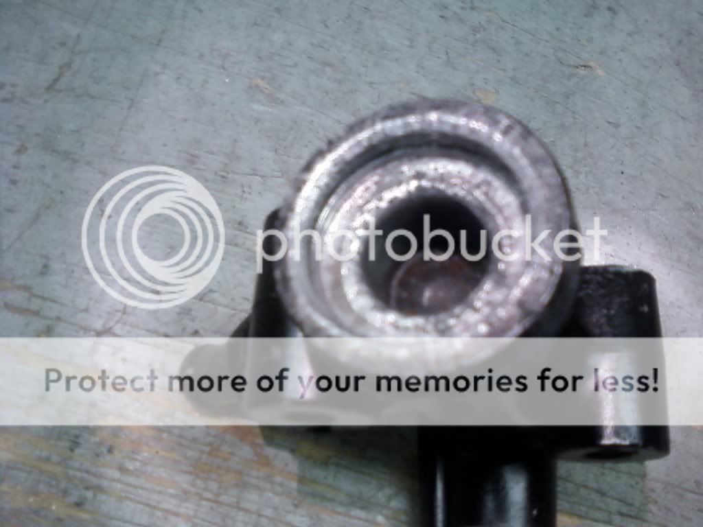

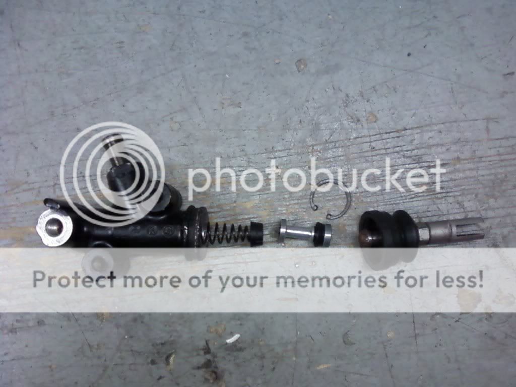

I'm trying to rebuild my rear master, but I can't seem to get it all the way apart. That, or I just don't understand what's going on. Here is what it all looks like.
Now, that can't all fit inside the cup there, right?
It seems to me like this part should come out, or something, but I haven't figured out how to do it. It looks to me like it just doesn't move, but it seems like it should move.

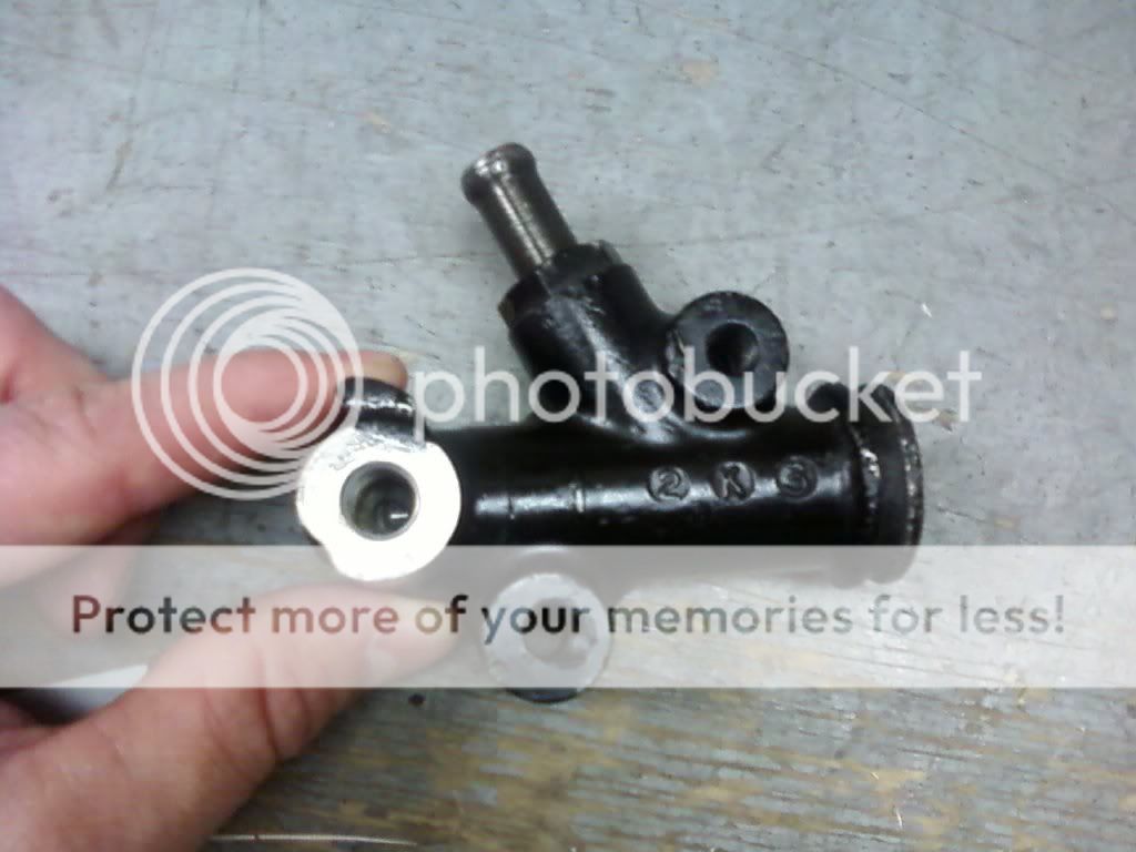

And this is what the MC looks like.
Am I just an idiot? I've read the Clymer book, looked all over this forum, and looked in the Honda service manual I got off of this forum. Can somebody walk (baby steps) me through this? How do you all do this, or does my stuff just look jacked and I need to get the GSXR rear master and replace it?

Are you the person who disassembled it? There shouldn't be anything else down in the bore other than the piston, cup, and spring. Did you remove all three of the old parts? Looking into the bore in that middle photo, it appears that an old piston is stuck in there, maybe with the old cup and spring below that.

Yes, I disassembled it. No, nothing came out. I was thinking that part of it was stuck. It's nice to know that. How can I get the old piston out? Maybe after work I can take some pics with a real camera, not my phone.
