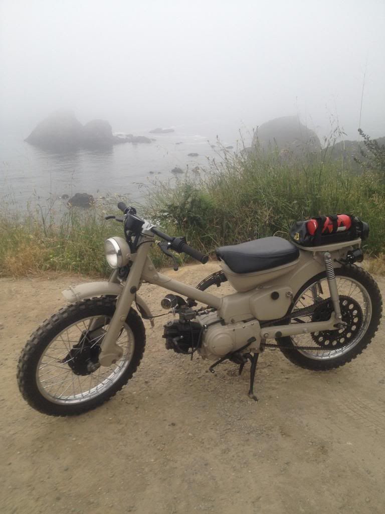

Sure thing!  Here is my bike
75 CB 550
And one of my 64 CT 200 I modified..
