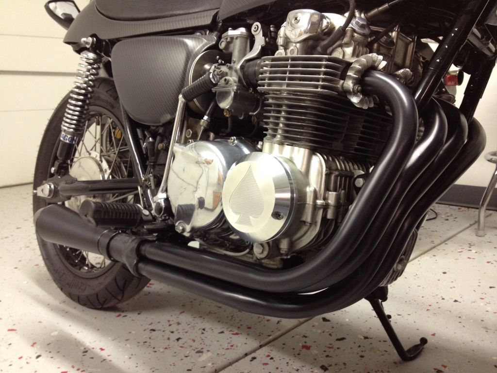

« Reply #17 on: June 17, 2013, 06:49:07 PM »
A local industrial coating shop in my area did mine for $150.
Very nice looking.  There's a guy here in Indiana that powder coated my frame and he quoted me about $14/LF to ceramic coat headers.
Are all your tins / plastics covered in carbon vinyl? Looks pretty nice.
No, they are hydrodipped. Tank, seat pan and side covers.
