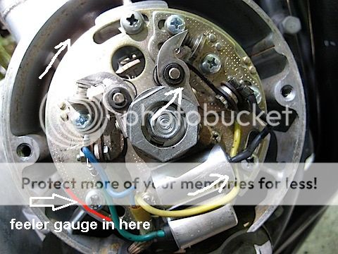

The other thing i have not really fiddled with is the ignition timing until today. Both honda and clymer manuals are not so easy to understand when it comes to point gaps.
-I basically need to rotate the crankshaft until the points for 1.4 are fully open, makes no difference where timing marks are, correct? then do the same for the 2.3? and use 0.3 or 0.4mm feeler gauge to set the gaps...
The Clymer not only says that the gauge you should use is 0.04mm, but also that when points 1.4 are fully open the index marks 1.4 must line up with fire mark? its contradicting to me... at the index mark and fire mark for either 1.4 or 2.3 the points contacts are closed....not fully open...
-after reading up a bit, TwoTired mentions that one should eliminate all lateral and vertical movements of the points plate by putting a feeler gauge between the plate and the case at one of the 3 screw mounting points, correct? this should actually be done before the point gaps are set to prevent any movements what setting ignition timing later on?
like this? The plate after the feeler gauge (red strip) will push the plate towards the other mounting points in the direction of the arrows:
once that is done, then there are different methods of setting the ignition timing, either strobe, or bulb methods? i dont want to get too far into that for now, as i have not fiddled with that part yet.

i set my ignition timing today, maybe not the correct method, but will see what you guys have to say...
-i turned the crank until point 1.4 had the largest gap, then i set the gap to 0.3mm.
-i turned the crank some more until the 2.3 point was at its largest, i set it to 0.3mm.
-i set my multimeter on continuity and placed one lead on ground and the other on the point 1.4. I turned the crank until it reached the F mark and rotated the points plate until the buzzer stopped ringing at just past the F mark. did the same for the 2.3.
it idles good and revs smooth, is that the correct method? I dont think my issue is with timing though..

i have managed to figure out the timing procedure and its spot on for 1/4 and 2/3. I feel i have accomplished something hahaha. Need to get my hands on a dwell meter and timing light now. would like to learn about the timing thing a bit more, hope to get a better understanding.

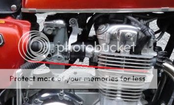

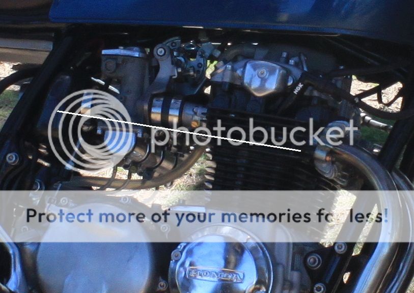

i am not sure the allowable tilt on these carbs, but to me, this could possible be causing this rich issue...
here is a reference line wrt the engines cooling fins:
but wouldnt it cause less fuel to get to the slow jets as they are positioned closest to the motor side of the carbs? the main jet would have more fuel to suck up though?
here is one of a standard setup, carbs float bowl parallel with fins:
« Last Edit: December 08, 2013, 01:04:21 PM by Bru-tom »

Correct me if I'm wrong but from memory the float pin/hinge is at the front of the carbs. The tilt on yours will lower the fuel in the bowls.
The floats will shut the valve sooner.
« Last Edit: December 08, 2013, 05:02:22 PM by LesterPiglet »
Offline Bru-tom
  • Posts: 514
Re: running really rough, desperate need of advice =/
« Reply #24 on: December 08, 2013, 08:16:00 PM »
the floats are hinged at the rear closest to the airbox, Sir..
i have also been using finger and hand gestures to try figure out what will happen with the rear lower, i may be dyslexic!  :o
