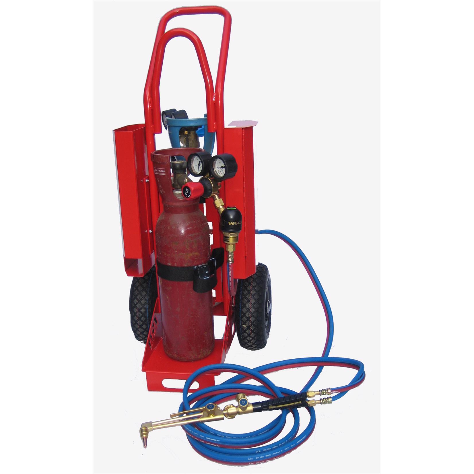

Too easy to do damage with oxy/acetylene and I think a heat gun wouldn't be enough. One of these would be better.
Nice, my brother in law has one of those I can borrow  :D
