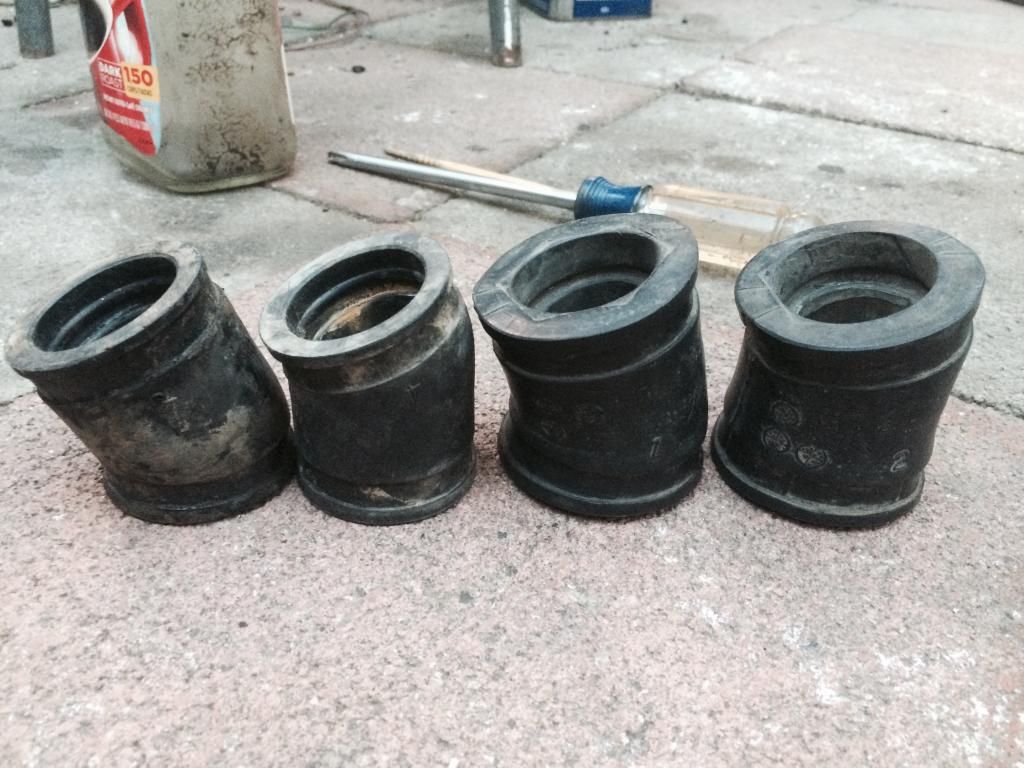

i was just doing this yesterday out of boredom.  old ROCK HARD carbs to intake boots...and we all know that these rock hard boots if throw hard enough at gas tank will make a serious dent to the tank.
two left boots have not been soaked.  the two right boots have been soaked over night
 one that had been soaked, squeezed with my fingers around the mounting edge
then squeezed the same one with my palm and fingers the whole boot
of course some members here will sarcastically say "The DIY-ers remedy for anything"

After about 10 minutes, I figured Seamus' carb boots were hard, too, might as well go into the garage and pull them off for this magical concoction to do it's trick.  Then, I heard, "WOOOOOF!"  I looked outside, and saw black smoke billowing across my driveway.  Adios, carb boots!
