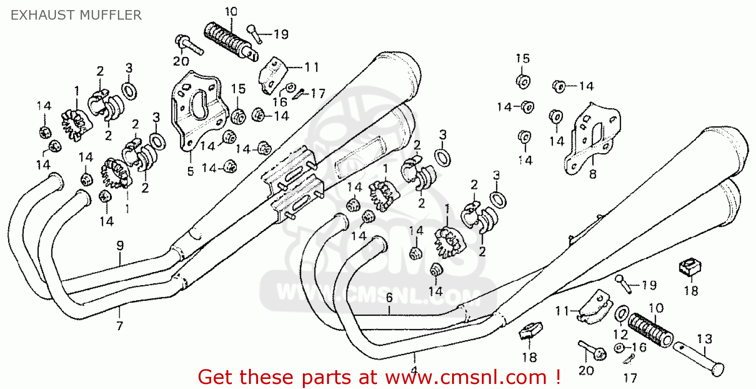

Okay, so 1" and 1.25".  Which are correct?  The cmsnl parts fiche shows one size, but not the length.  Is it possible/easier to convert to the F exhaust mount?

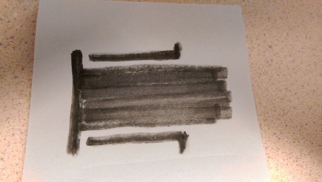

« Reply #9 on: June 04, 2015, 08:47:00 AM »
shiity drawing, but this is how the half moon collar integrates with the flange.

« Reply #10 on: June 04, 2015, 08:48:41 AM »
Hmm... No wonder. I'm glad I've got you guys to knock some sense into me. I imagine that'll speed the install along too
