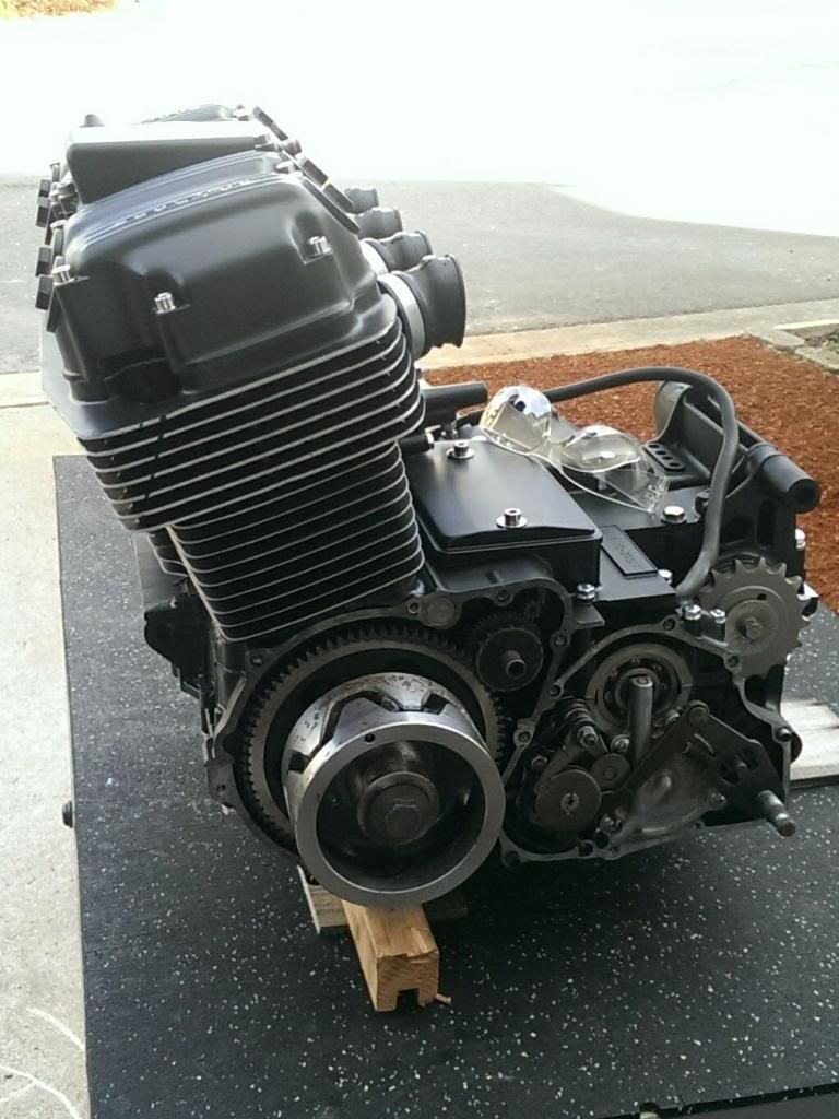

Your engine paint came out great! I also want to do the cylinders black, although I was thinking flat or satin black. But the crinkle black looks very nice!
Thanks for the tip on the forceps to hold small pieces of scotchbrite, will definitely use it.
'73 CB500 frame with '76 CB550 engine build in progress http://forums.sohc4.net/index.php/topic,148166.0.html
'09 Ducati M696
Re: engine primer
« Reply #6 on: June 08, 2015, 04:55:53 PM »
Duplicolor low gloss black engine enamel...
Offline lajos
  • Posts: 80
Re: engine primer
« Reply #7 on: June 08, 2015, 05:21:52 PM »
Looks really nice! How did you get the highlights on the fins? Sanded off the paint after it was cured?
Maybe I should consider all black. It probably doesn't require as much cleaning as gray.
'09 Ducati M696
Re: engine primer
« Reply #8 on: June 08, 2015, 05:36:46 PM »
Yes.  I block sanded the fins after paint.
